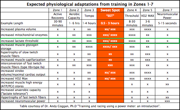

So just to follow up on this: “Day 1 = 2x20 with <5 min between @ ~95% of FTP”
This means riding 2 rides for 20 minutes each with a 5 minute break at 95% of FTP. I guess I thought that short-term intervals were the way to get faster. Just wanted to make sure I was riding this right. 20 minutes seems longer than what I have read in the past - typically 2-4 minute intervals. Thanks!
Yes, threshold intervals are typically 15-20 minutes long. I usually do 2 x 30’ or a single 60-minute interval at 93%-95% FTP. 2-4 minute intervals are VO2 Max intervals.
It boils down to specificity. You want stronger biceps, do bicep curls. You want to improve your sprint or crit performance, do VO Max intervals. You want to improve your FTP, do longer intervals either at or near FTP.
