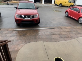

I had originally had that weird curvy concrete and then grass and I have them rip out the grass and put in the pavers. The first guy did a crappy job and didn’t put the layer down that keeps the weeds from coming up between the pavers and not enough sand and it look like shit so I had it redone. The second guy did the job the right way and was actually cheaper. This is from today.
