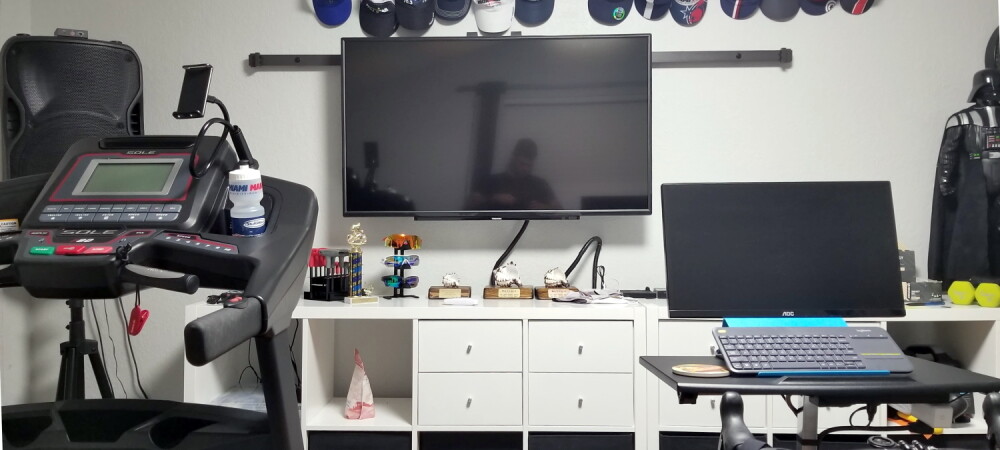

I have a sole f80, probably similar sized to your Nordictrac (not sure, but guessing.)
I put a 32" TV on a freestanding metal tripod and it works great. 42" TV would likely work fine too. For mine, the TV is at eye level and I can see it straight over the TM console without looking upwards.

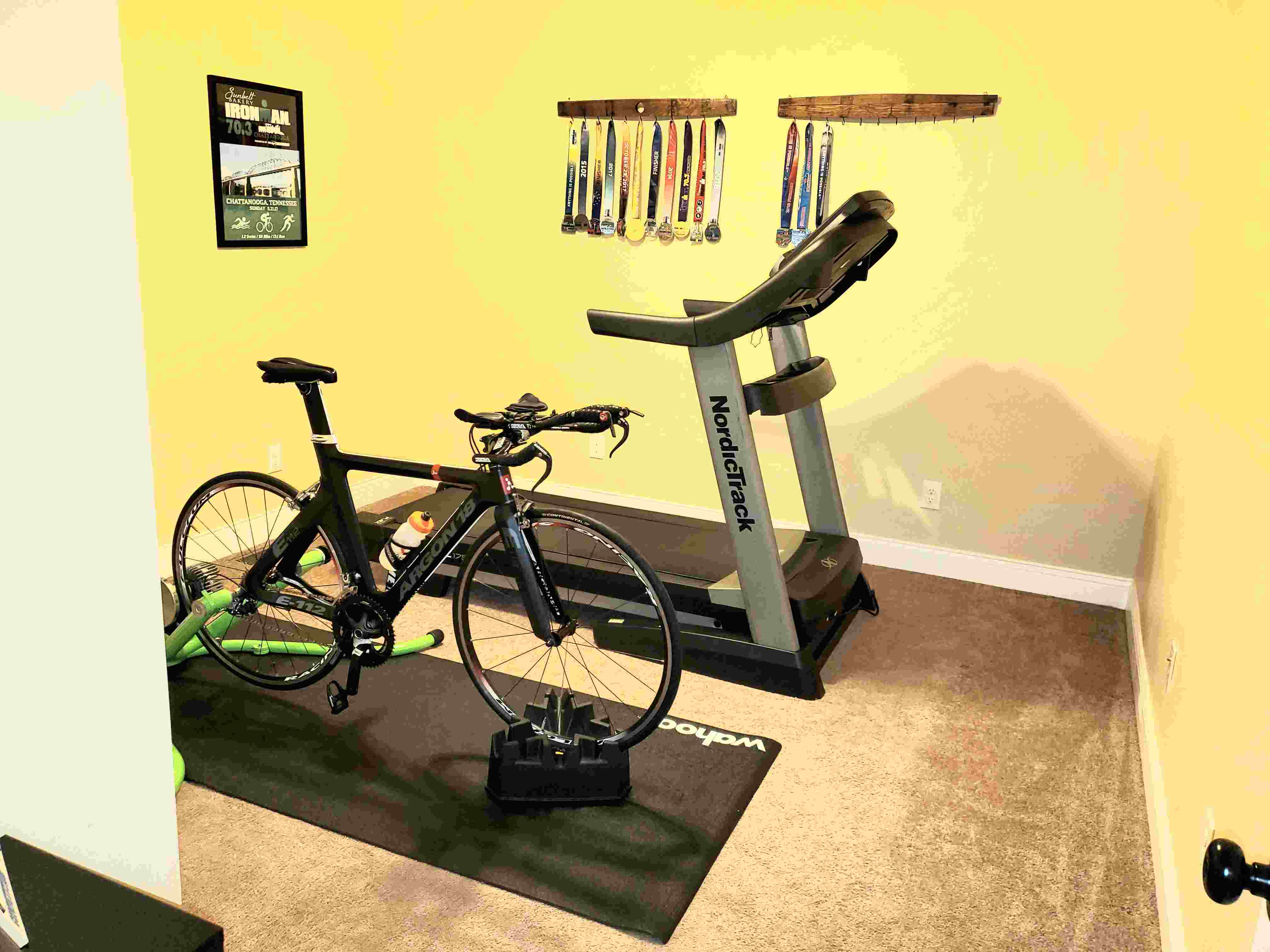

I finished assembling my Nordictrack Commercial 1750. I’m waiting on my treadmill mat which is coming tomorrow. I ordered a TV stand for $68. The last thing is to get a TV.
Here’s what I went with for a stand.
if it’s facing a wall, you can go with a barn door slider setup like I did. i built a “VESA compatible” tv mount with a scrap piece of plywood to attach to the sliders on the rail.
