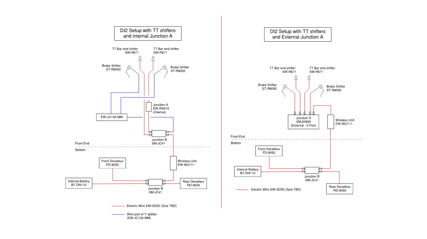

There are a bunch of threads about it but here is a basic diagram showing the internal or external options for the Junction A. Wire sizes vary, below worked for my P3 which is a 2018 61cm. Bettershifting.com is also a good resource. Cheapest way to do it is used obviously, I’ve seen some decent used sets for around $700 or so, usually doesn’t include the battery charger though. I got majority of a set (brifters, battery, RD, FD, charger, JA, JB, wires) for I think $550, then shopped around for bar end shifters, wireless unit and JA/JB that I needed. Lots of different ways to route the wires, pretty much as long as you have the components wired to a battery you can make it work in a variation of ways.
Fantastic start. Thanks to both. A bit vague on the Junction A position. Internal or External?
Depends on which type of A Junction you use.
See? I didn’t even realize there were different ones. Surely there is a list/diagram of the components that were sold on the 2018 P3. It was an option I couldn’t afford at the time, but it existed, so why re-invent it? I’m good with a wrench, if I have directions to follow.

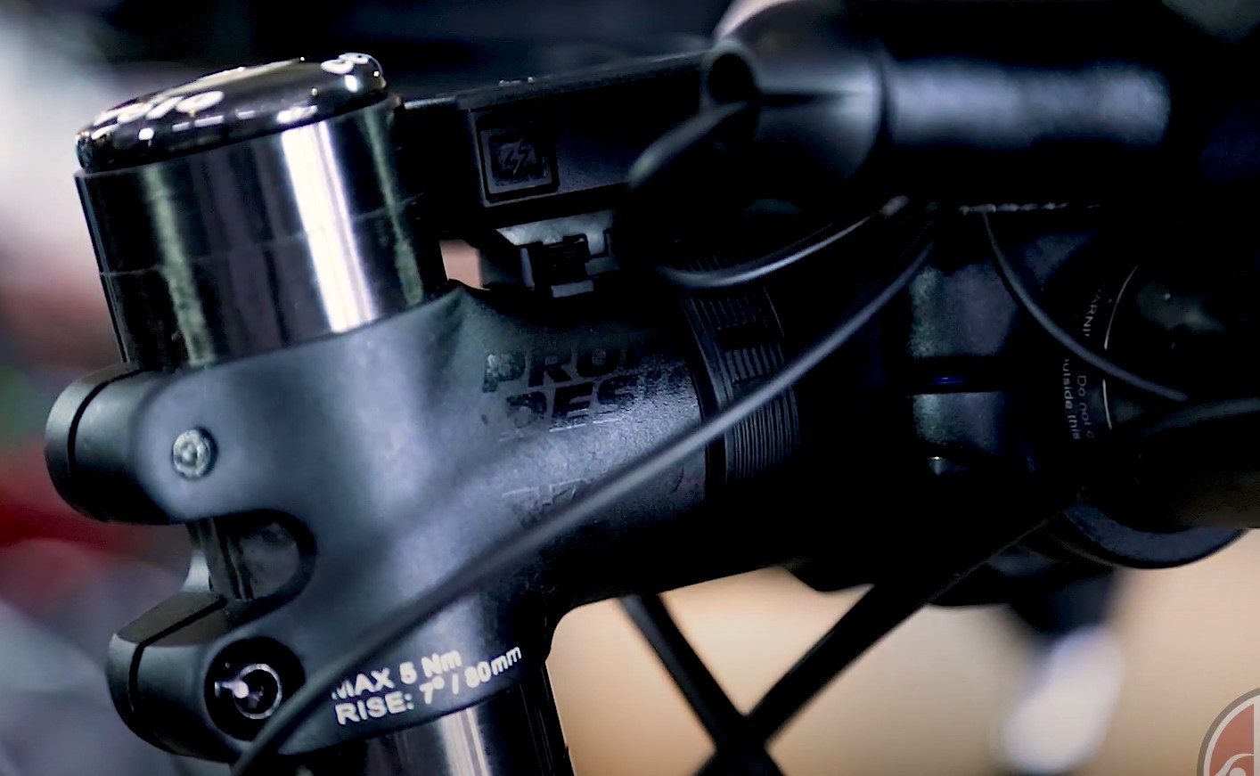

I have the external junction box mounted to the side of stem with the rubber band thingie In a position where it’s mostly shielded behind the PD aerobar bracket (narrow aerobar setup). If I were to do this again I’d use the EW-RS910 internal junction box mounted in the end of one of the aerobars along with a SM-JC41 junction box.

No one can tell you how to wire everything because it depends on the specific aero bars, base bar, and stem that you have on your bike, and the way that you want it to look.
The location of the A Junction depends on which A Junction you have, where it will fit, and how you want the bike to look.
If you have four wires in the front of the bike, you can connect them together in the front and run one wire toward the back, and then connect the front derailleur, rear derailleur, and battery.

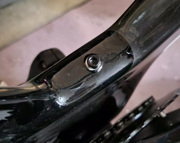

what is this bolt for?
I assume these bolts on the bottom are for holding a battery. But I’m not sure how I would slide that in, with the sealed bottom bracket.

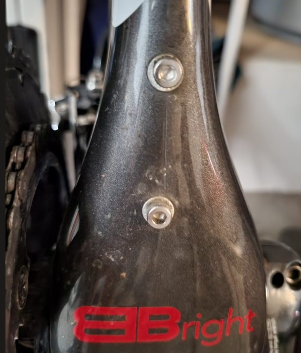

Those bolts on the bottom can probably be used to mount the external battery mount (BM-DN100 is the current model, SM-BMR2 the previous). The battery itself is SM-BTR1.
