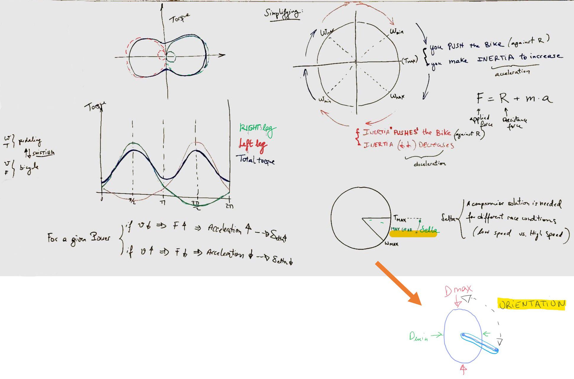

For a chainring, whichever shape non-round is usually called OVAL. Here we are going to call them “OVOID”, a term that includes the ellipse, the oval, and those with more complex shapes as it’s the case of Osymetric. In general, these chainrings work like having different chainring size along with the complete pedal revolution to adapt the effective leverage of the machine to the geometrical disposition on your legs at that pedal position, and in general, reducing the leverage near the dead spots and of course, making it bigger in between them.
OVOID Chainrings are mostly characterized by having 2 parameters: stretching ratio or OVALITY, which generally it can be defined by % , and ORIENTATION, which some brands call “timing” or “clocking” defined by the clockwise angle formed between DMAX and the crankarms.
Even for the biggest fan of OVOID chainrings, ORIENTATION is a crucial factor, so much that it is a much better option to use ROUND chainrings than using a wrong ORIENTATION when using OVOIDs.

Osymetric is very well known for succeeding in big Tours and TT races (including Ironman). Based on its unique ORIENTATION which increasing leverage too soon in the downstroke, is only useful (IMHO) for those riders who push on the pedals earlier that the average. And having more OVALITY, the ORIENTATION factor becomes even more important. ROTOR Q-Rings, succeeding in all kinds of races and disciplines, at ROAD, MTB, TRIATHLON, CX… (and even HANDBIKE): Olympics, World Championships, big Tours… Climbing, Sprinting, or at TT. And for these results, different kinds of ORIENTATIONS have been used.

There are not scientific conclusions, but here it is a fact: having a smaller gear at the dead spots and a bigger gear when the cyclist applies more torque, modulates the output, the force you put on the wheel, making it more even for improved traction. This is just Geometry, Mathematics and Physics. Therefore, there is a benefit on slippery conditions which is an advantage in MTB, GRAVEL, or CX. Furthermore, the more even tension on the chains could improve the chain’s lifespan.

Reducing the effective chainring size at the dead spots helps to soften tension at the knee when it is at its maximum flexion, bringing the logical benefit… but if ORIENTATION is wrong and the biggest leverage (and resistance) appears, for example, too late in the downstroke, you will feel like “stepping in a hole” and another kind of knee pain will be generated, caused by the use of the OVOID chainrings (if you don’t correct that wrong ORIENTATION). It is not strange to read at different internet forums people who have found this kind of knee problems after using OVOID chainrings.

We could consider the variation of the shape of the OVOID chainring as a shifting system, which in general in a vehicle is good because we can reduce or increase gear when we need it, mainly based on the speed, slope, and inertia. Therefore we can imagine a shifting timing “robot”, corresponding to that ORIENTATION, becoming a critical factor, based on the geometry of your legs, on your position on the bike, on the different inertias coming from your legs at a regular cycling cadence, but also on the inertia of the complete system . Consider that, when pedaling, we are accelerating and decelerating the bike (with the cyclist) twice every pedal revolution. And it is mainly because this acceleration that the max leverage must be delayed regarding the position where max torque is located. If you are at a trainer, all the inertia of the system may vary significantly, which easily results in different ideal timing for this modulation of the instantaneous effective chainring size.

How to know if your ORIENTATION is OK?
Of course, we can adapt to different race/pedaling conditions taking advantage of the ankle-play and shifting gears, but because the pedaling conditions are widely spread during a “race”, considering the range of useful cadences and different positions, more forward or backward in the saddle, or even out of the saddle, etc. only if we target it properly will have a really useful OVOID chainring.
ORIENTATION is a more critical parameter for ROAD racing than for MTB, in the same way as having a shorter gap between consecutive gears is a must for ROAD. For this last and considering the 15 years of experience in elite and professional racing I would say we have a reasonable range of ±2° for which we can use OVOID chainring with good results when for MTB it would be a wider range, let say something like ±4°.
The amplitude of these ranges is such that having only one and appropriate ORIENTATION option (the one that ROTOR names OCP #3) it can fit about 50% of the riders for ROAD and about 75% for MTB.
For example, imagine the ORIENTATION is too short, by just 4° (which for Q-Rings means that you are using 1 unit of OCP numbers under your best one…) Then, at a general pedaling pace, you were finding too much resistance very soon during every downstroke and losing acceleration ability, and for compensation of both, you would be correcting using ankle-play and shifting gear for reducing that bigger resistance by increasing cadence. In the opposite, if your ORIENTATION is too long, you were finding too low resistance at the beginning of the downstroke and, at a normal cadence, having very good acceleration ability but difficulty to keep a high-speed pace, what could be the case of some comments like “stepping in a hole”… In this last case, you would be correcting using shifting for a bigger gear to increase the perceived resistance. Therefore, it is reasonable to hear some people saying that the “oval” rings make you reduce the cadence, and vice versa, always depending on how well each OVOID is oriented for their particular biomechanics.
One quick check in order to see if your ORIENTATION is Ok, is when you pedal in the top of your range of cadence, because pedaling so fast you lose the ability, by using the ankle-play, to adapt to a non-optimal variable rotational speed: inherent to a non-best ORIENTATION of the ovoid shape of the ring, you would have a bumpy feeling as if the bike is jumping (following the alternating inertias of your legs).
