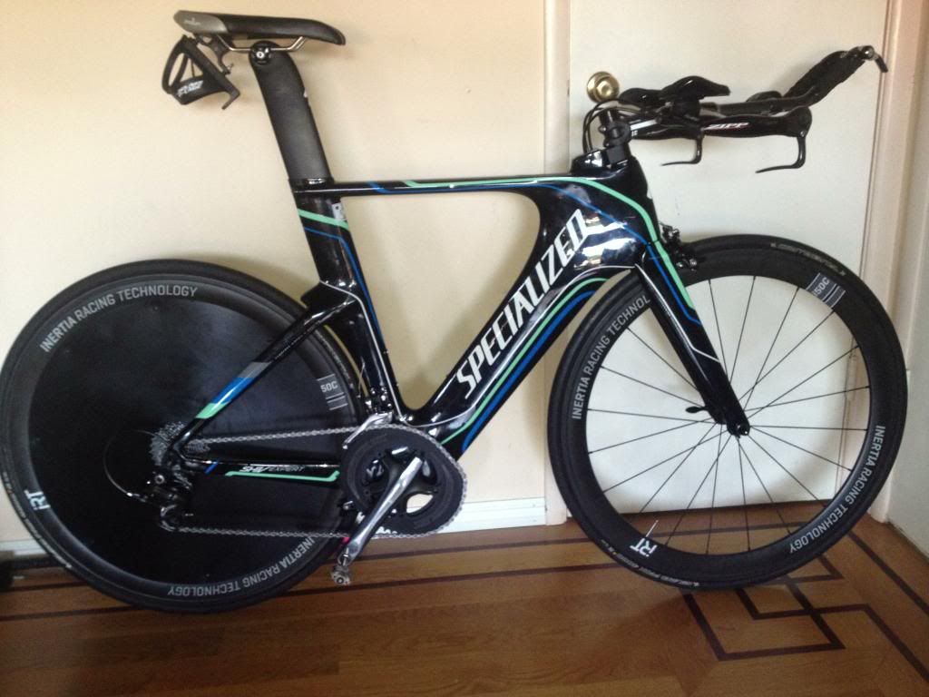

Here she is! Finally finished!!!
2012 Specialized Shiv Expert(unreleased color way)
Dura Ace 7900
Zipp Vuka Aerobars
Ism Adamo Podium
Speedplay Zero Ti
170mm crank length
54/42 osymetric rings
http://i1168.photobucket.com/albums/r497/radtechsof08/image.jpg
