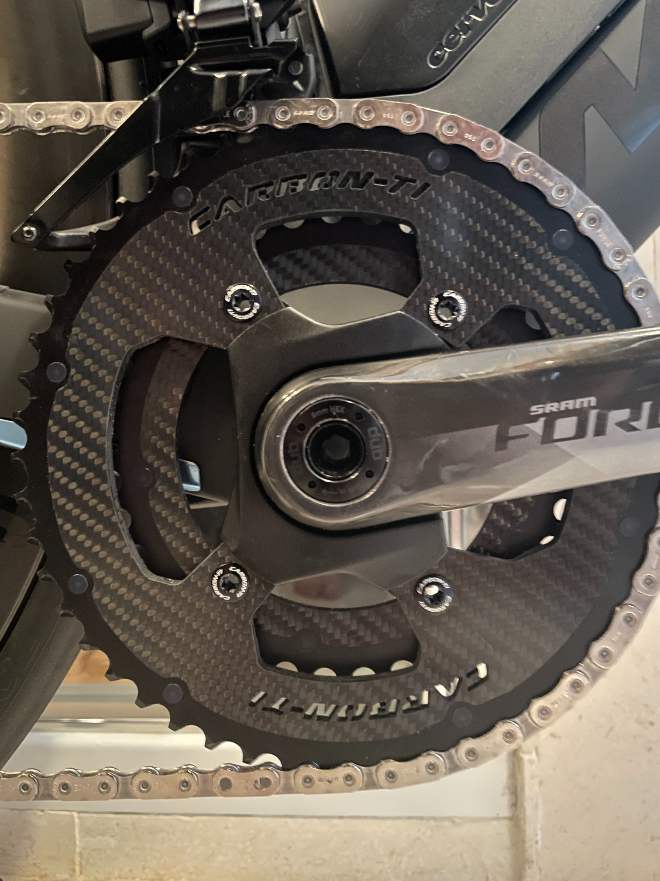

Is anyone running this set-up? I’m interested in changing up from 52-36 as I changed from 155 to 165 cranks and now I’m running a bit short of gearing. I’ve read that 53/54 is about the limit for 110 BCD, which might explain why I’m struggling to find options. I found a 54-40 from Carbon-Ti (which is very expensive) and Rotor do a 54 but only in oval ring (which I might investigate further but would be a case of the ‘tail wagging the dog’ as I’ve never considered using oval rings). Grateful for a steer if anyone is aware of a product I’ve missed. Thanks.

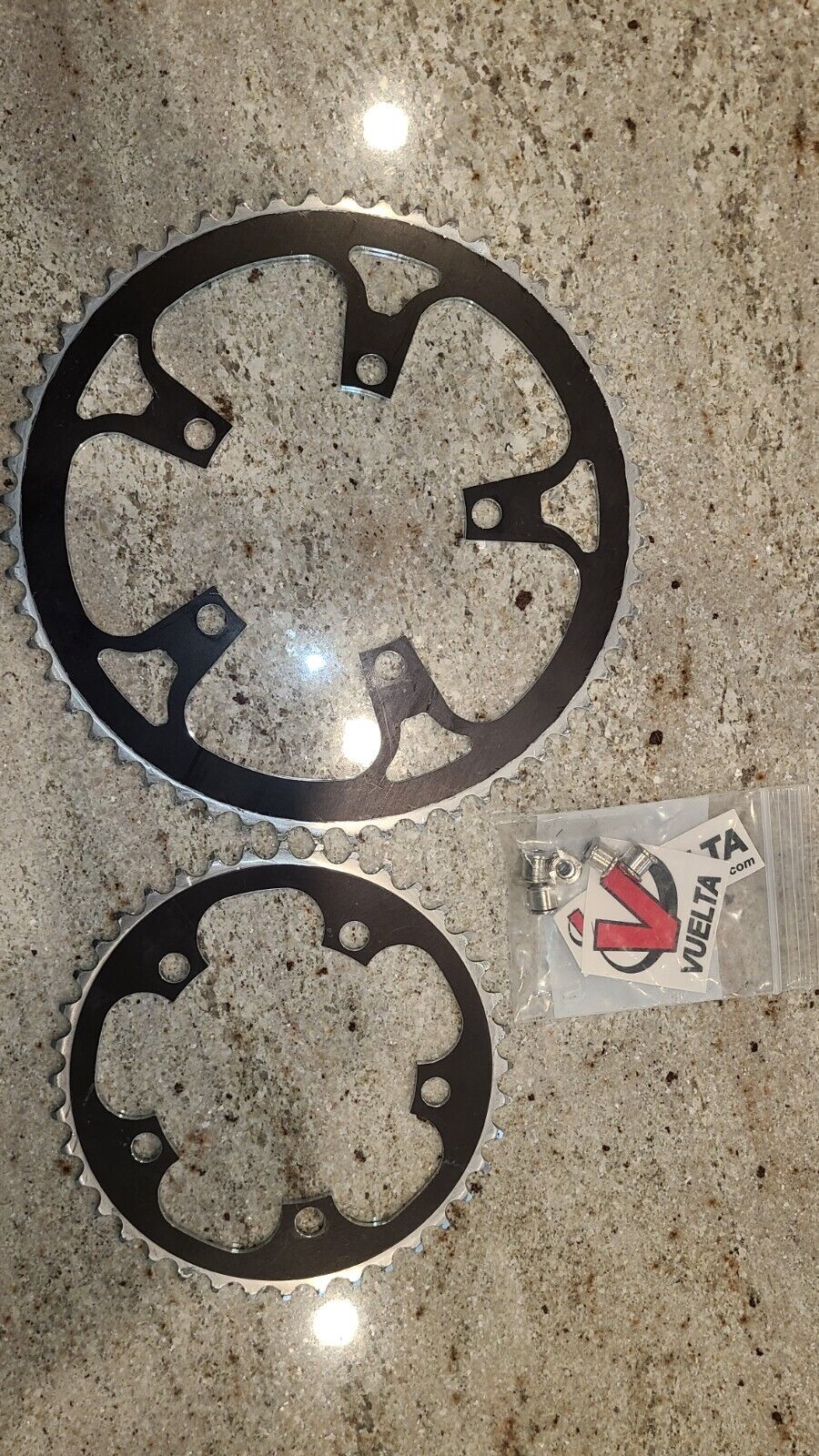

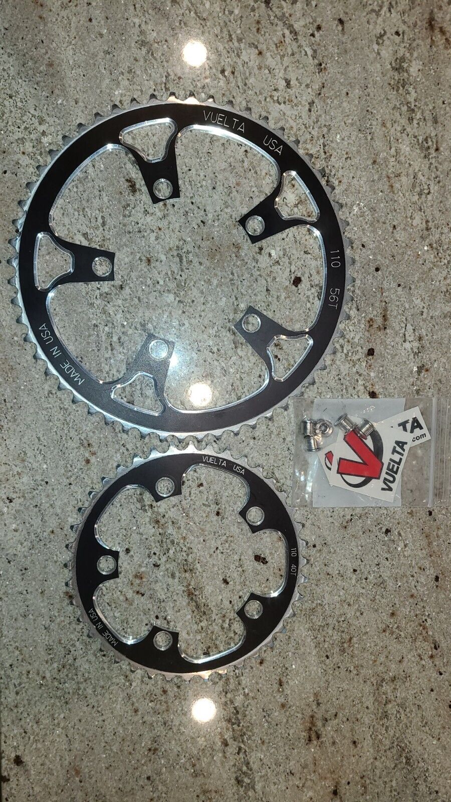

I have a set of 56 outer and 40 inner in 110 BCD 5 bolt. I will sell them cheap. I ran them 2x.
Do it! Do it! They look amazing! 😈😈😈🤪🤪

Haha - yes, they look great!
