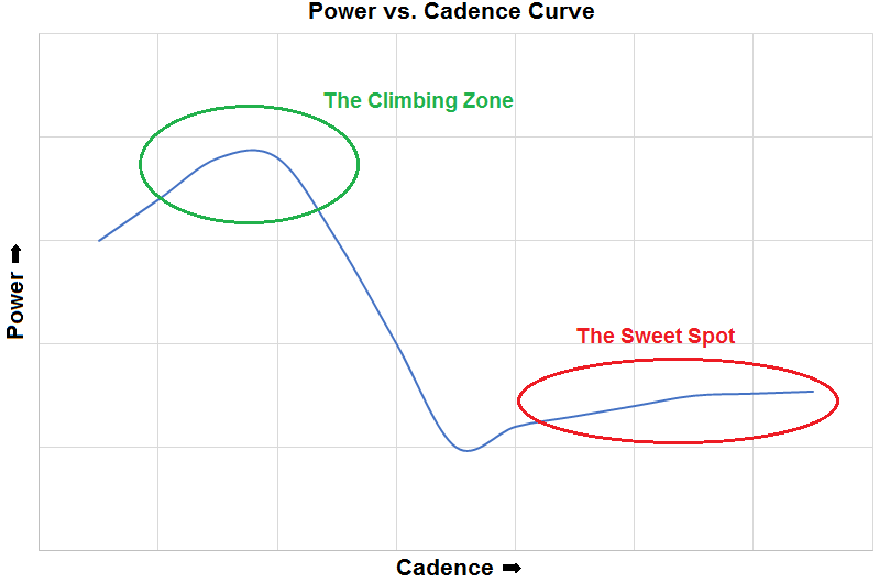

Does anyone know of a free online tool that could do analysis and charting of FIT data? I would love to chart my power vs. cadence over a few of my rides that had some terrain diversity. I did it against my 5 mile Garmin splits of my last HIM ride that included a mountain climb plus some really tough shorter climbs. But, the data were not discrete enough. I suspect that most of us have a power & cadence curve that looks something like this. For mashers, the range may be compressed and flattened. But, for spinners, I bet there is a very high peak at low cadence where we are climbing and then a sweet spot that may only be 5 to 10 RPM wide where we are cruising at IM/HIM/Oly/Sprint race speeds.
My amateur observation seems to conclude that a rider that is higher in body weight, and thus also has heavier and stronger legs is able to pedal at lower cadences. However, the opposite seems to be true too. A 140lb rider with not as heavy and strong legs, is able to spin his/her legs around much quicker without consequence, and therefore is able to try to hit higher W/kg numbers with not as strong legs. I weigh 155, and my sweet spot seems to be around 90rpm. But just by chance, not because I am targeting that really. I do agree with the above that if I am climbing a hill, I may let it ride up to 100rpm, and if I am in the draft zone on a long flat, it could easily fall to 80, maybe even 75.

TP can do quadrant analysis for any single ride; I don’t think they have an agregate version to span multiple rides. But, I don’t know if that’s limited to the paid version or available in the free version as well (I’m a paid member).
I don’t recall any of my graphs looking like that, though. But, I’m also a product of the brainwashing since I started cycling in the pre-Cancer LA Era. I can’t check from work, though…stupid browser incompatibilities.
How much of that low-cadence climbing is dictated by gearing restriction than optimal/comfortable cadence? I personally like to ride around 90 rpm. I don’t aim for it, as I don’t monitor rpm while riding, but when I review my ride data afterwards, my average cadence is always around 90 and my variability is minimal. Uphill, downhill, riding hard, cruising; +/-90 is generally what feels good to me. It’s pretty flat around here, so I can get away with close ratio cassettes (12-25 on the tri bike, 12-27 on the road bike). When I do hit the occasional steeper climb, then, I’m often forced to go below my preferred cadence. I frequently end up over-powering to keep the cadence from going even farther below the comfortable range, and to get the damn hill over with. Or simply to keep the wheels turning fast enough to maintain balance. Does’t mean I’m more efficient at lower RPM, but rather than a low RPM was forced on me by my lack of low range gearing. That’s the give-back for having the tight-range cassettes that allow me to stay close to 90 rpm the rest of the time.
How much of that low-cadence climbing is dictated by gearing restriction than optimal/comfortable cadence?For me, it is 100% dictated by a hill when I run out of gearing. The only time I go below 80 is on double-digit grade climbs when I am bound by my easiest gear. I drop into the 60s in the high-teens grade, and that is when the smoke starts coming out of my ears. I could ride those hills significantly faster if I could magically drop a 36 tooth gear in back just for the one-time beast mode climb.
I never aim for cadence when training or racing; I just look at it after-the-fact for curiosity. What I have observed in my riding data runs contrary to a number of comments above. That is, when I drop below my naturally selected cadence, it is most often because I am increasing power on a >6% climb and I am bound by gearing.
