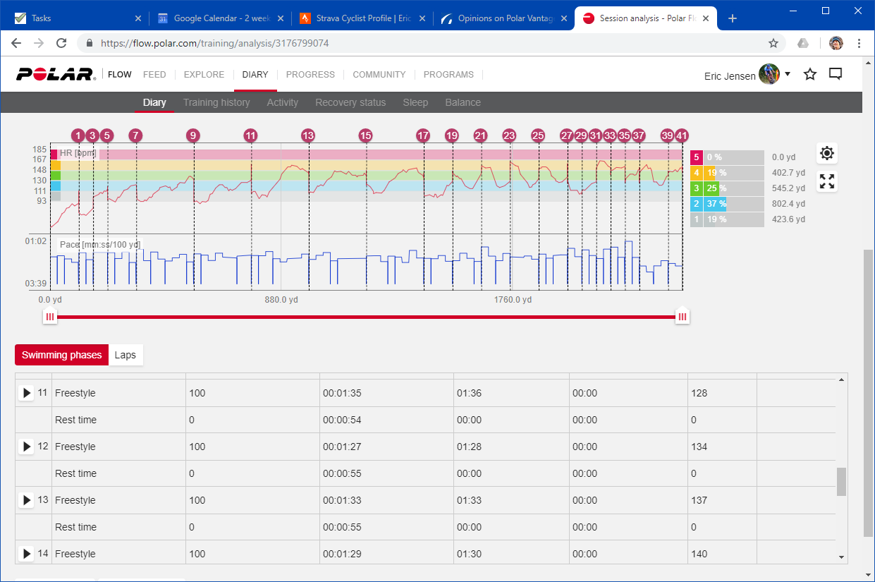

Sorry for the onslaught of seemingly dumb questions. But the swim tracking. Does it track drills too? This is one of the reasons I’m looking to replace my VAHR. Battery life, no tri mode or open water (I use a 910xt for racing and open water), and it doesn’t track my swim drills very well.
No, you’re all good. So yeah, there is open water (GPS) and pool (accelerometer) modes for swimming. You get data like this:
Is that what you mean?
The only time I’ve had the slightest problem is when doing kick sets (the watch has no idea you’re kicking :slight_smile: )
-Eric
