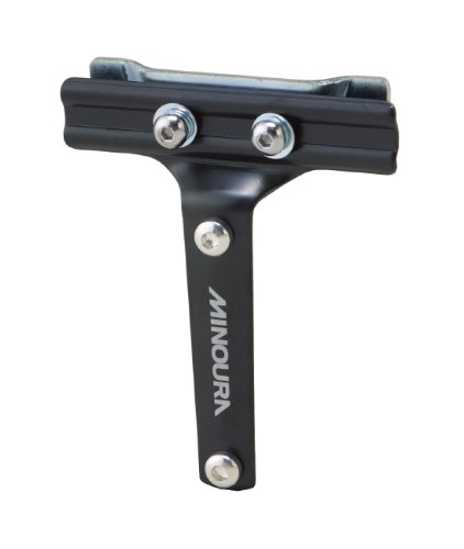

I have a Fi’zi:k Tritone saddle. I am going to be doing HIM Racine this July and was wanting to only mount one bottle out the back of saddle. Is there anyway hang one bottle out the back, or am I stuck with the two stock mounts that come one the saddle?

I had the tritone and that was one of my issues. I loved that it had an integrated hydration solution but the two bottles was always overkill for me. You can try to zip tie a single cage there but that saddle design would make it pretty much horizontal; and therefore pretty tough to get the bottle out unless you have much longer arms that my t-rex arms.
I actually switched over to the Specialized Sitero saddle because it had just the single cage mount directly behind the saddle. I also have a Koobi 232T that has a bolt in the back for their hydration module. I never got their module but I used a “King Cage” stem mount bolted to the Koobi and it gave me the same single cage mount directly behind the saddle.
So if you love the tritone saddle, you will need to get an aftermarket solution from xlab, or do the horizontal zip tie method. If the tritone is a “meh” fit for you, try one of the other two above as my suggestions.

Thank you for all of the help and options guys. I am not sure the specialized option will get around the hydration setup that already exists on the Tritone. I am going to see how the zip ties work, if I can get it at a tolerable angel or if it will just end up being horizontal. This would be most desirable just from a cost perspective.
I was hoping to stay away from the aftermarket bottle brackets. I will make that a last ditch effort. If i get the zip ties to work I will certainly post some pics.
