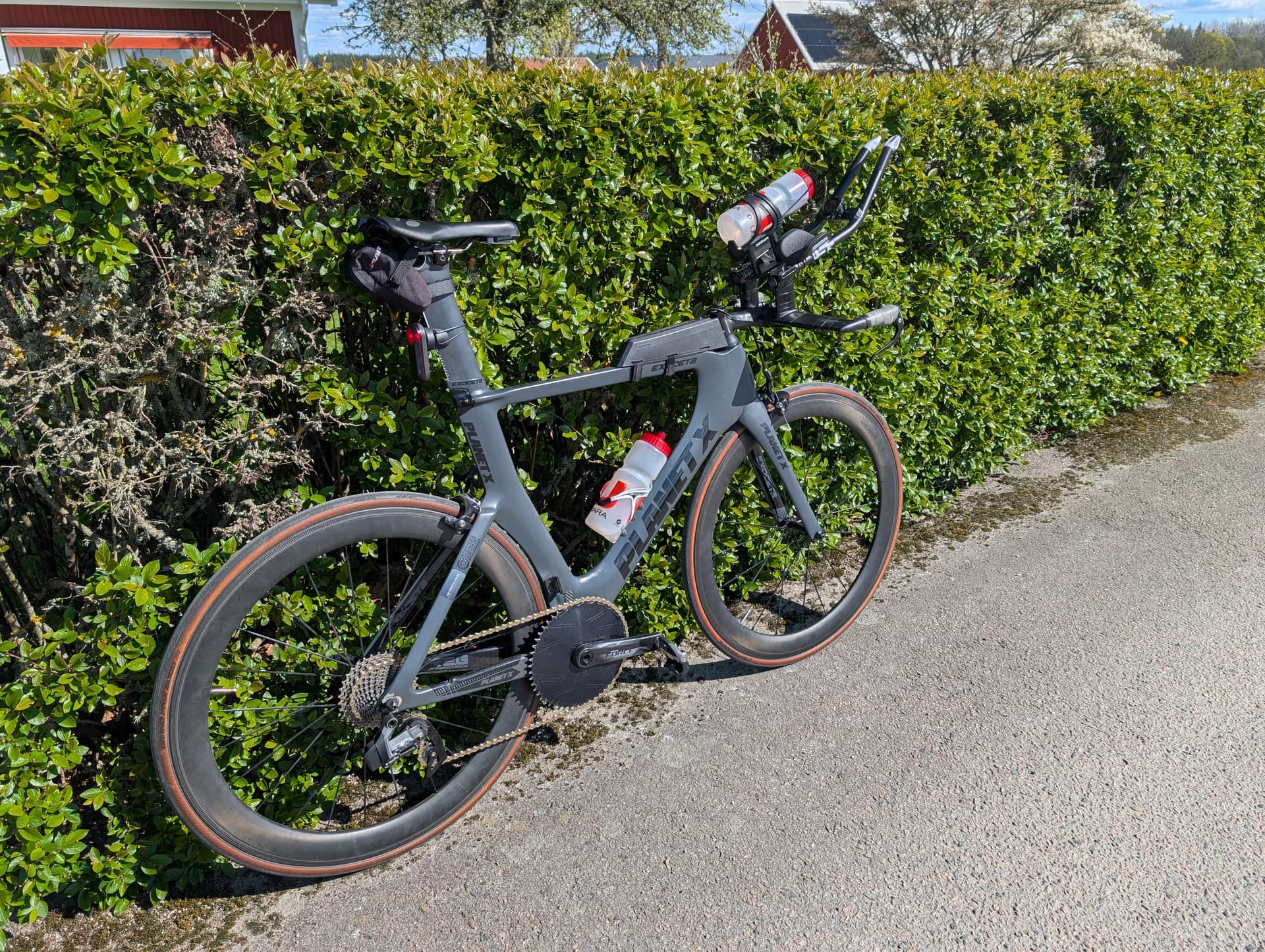

I worked a little on the bike (rear bottle cage, cleaner front end, position).

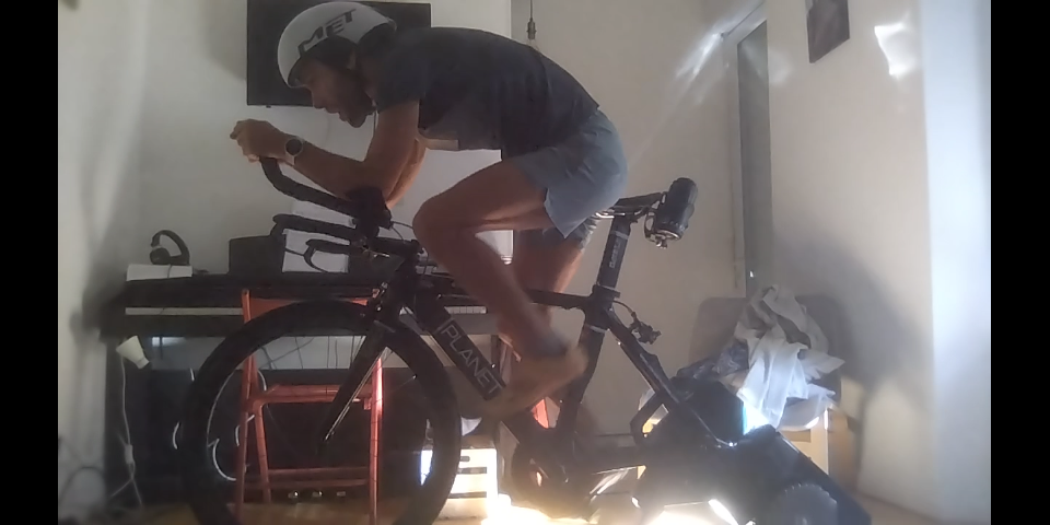

I did my first TT this weekend. I finished the 22k (200m of elevation) in 32:27, 41.4km/h. 316W normalized power (308 average). There is elevation and the back of the loop was very windy, but the watts seems high for the speed (4iii unilateral powermeter).
I could certainly find better suit, socket and shoes…
But mainly, I think my arms are not far enough from my chest so my head stay high.
Any advice ? Better to change the stem, will it be better with a saddle more forward ?

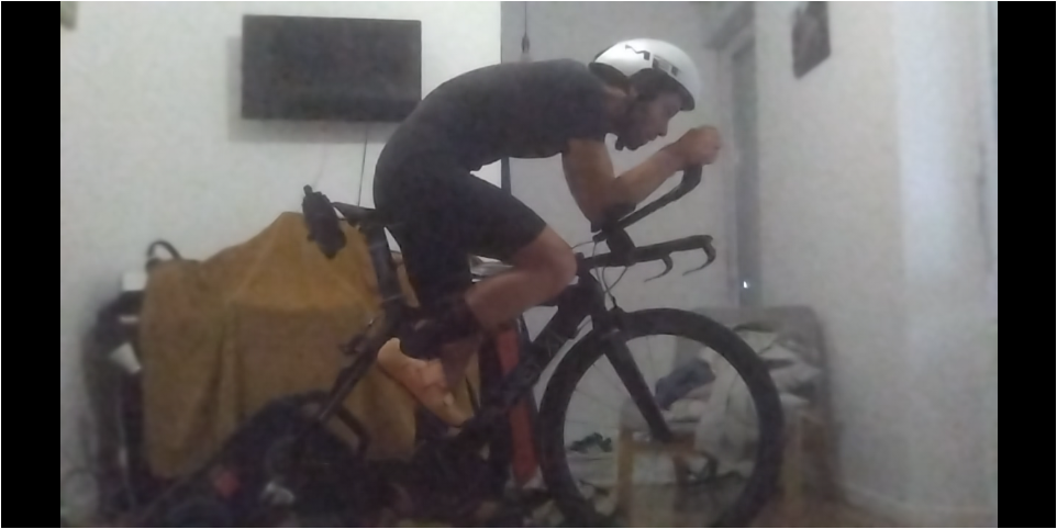

Much longer stem, flip it over to more horizontal and remove some spacers while your at it. Try to rotate your hips forward (might need a saddle change).
I tried a longer stem and removed some spacers.
Dont know if it seems better :thinking:

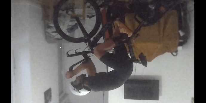

How is your comfort level? If that is how you typically sit on your saddle, I would consider sliding your saddle back by about 2 cm and then maybe reposting a photo of your new position.
You probably don’t want to hear this, but, based on your body size, your riding position, and the stack/reach of that bike, you probably need a bigger frame.
ps. you might get more input from others if you can flip your photo around …
My comfort is great like that. If I go backward on the saddle, I got hip pain.
I’ll certainly change the bike for a more recent one…but not this Season !

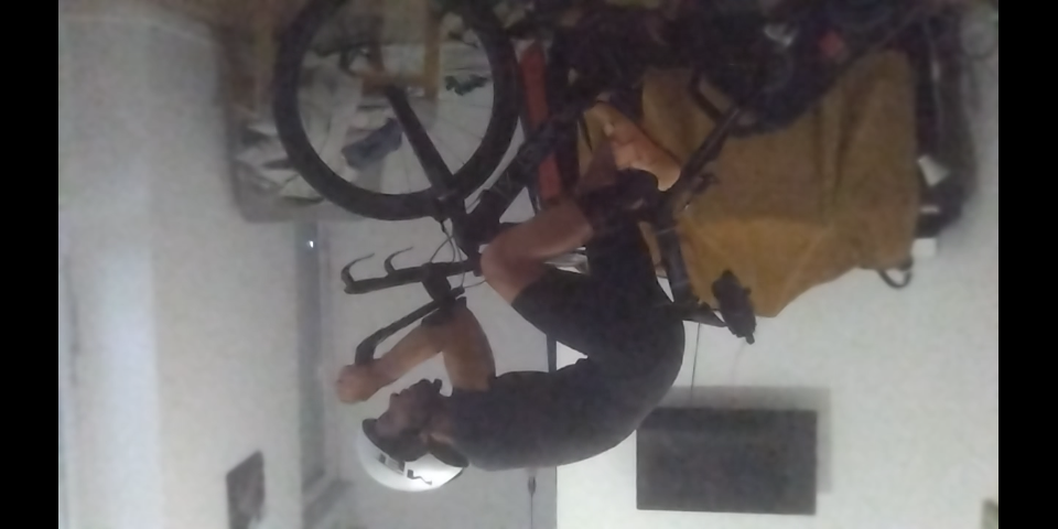

Have you tried to remove maybe one or two spacers under your armrests?
If yes, how did that feel? Can you post a photo of that?
I took off one spacer and lower the angle of the bars on this one… I start feeling less comfort but don’t know if it’s better
It looks a little better.
But, for safety reasons, l would not sit that far forward on your saddle. That frame is not designed for you to ride that far forward.

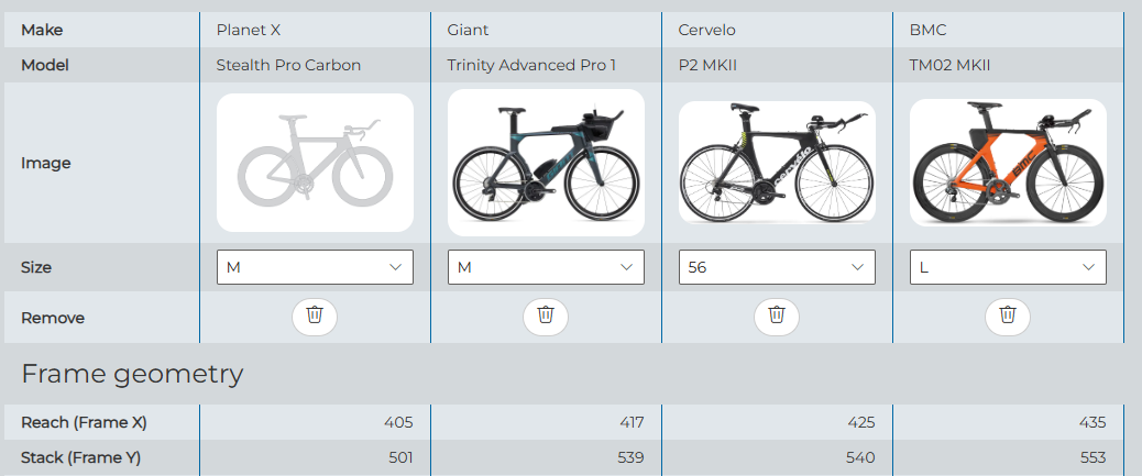

After a season with this bike, I have the opportunity To buy a giant trinity. Its not the latest one, it comes with brake pad and ultegra groupset.
Ive got 2 doubt: it s a side M. My stealth is also a size M but I need more reach… Will the trinity be ok ?
I like the ability of the stealth To climb (live in the alps). Is the trinity also versatile ?

Find the sizing charts for both bikes. Compare reach.
Do you know how much more reach you want? If so, some simple math will help you out. If not, the question is harder to answer.
Off the top of my head I think you have at least 50mm more reach that you could try and still be comfy. Increasing reach also typically has an outsized benefit on reducing drag.
Hope that helps
The Trinity is only a little longer reach (12mm) and a lot taller (38mm). The rim brake Trinity bars are not adjustable, so it ends up costing more to buy aftermarket parts to change the position.
You’re better to look for something that has a longer frame and easier adjustment
Thanks a lot
I effectively need around 5cm more length, but I need the handlebar to stay high because not much flexible…
Do you have frame advice ? A p2 maybe will suit better ?
You can see the Cervelo and BMC would give more length

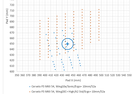

Part of your problem is the clip on aerobars - when you tilt a clip on that has tall risers it moves the pads back a lot. So a taller frame will help, because then the risers will be lower which means the pads don’t move back so far.
The ideal would be an integrated bracket that has tilt, like the Profile Design A2 (FYI I work for Profile Design), because then you don’t move the pads back so much with tilting.
You would find that your position would be quite easy to achieve on a larger frame with the right bars, plus the frames mentioned above have more forward adjustment for the saddle.
As an example, you can see the increased fit range of the A2 bracket (orange) vs a clip-on (blue)
