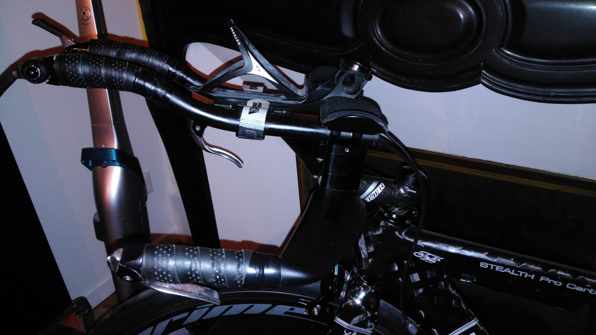

I’ve got a planet-x stealth tt frame and I’d like to improve this base if possible.
If think it could mainly be done in the front of the bike.
I’ve got a flat carbone handlebar (progress pg-241) and an old school stem with spacers behind.
I thought about putting a more Aero stem, taking of the spacers and raising the bars. Maybe putting some angle on the bars also.
What do you think ? What else Can i improve ? (internal routing I imagine)
Thanks a lot
Ivan
You could replace the bars with something like a tririg Alpha.
Switching from S bends to ski tip extensions is almost always faster.
Try to clean up cable routing, maybe drill some ports and move it internally
What I would not encourage you to do is dump a ton of money into this project. That bike wasn’t that fast to begin with. You’re about 8 generations removed from a top of the line bike. Each older generation is 4-8w slower than previous gens depending on bike brand.
Let’s say your bike is 50w slower than the top 2-3 bikes on average. You may be able to get it within 25w slower. At some point you’re going to hit a wall.
That bike will never get within striking distance of a rim brake P5-3 or P5-6 and the rim brake P5-6 is still 10-15w slower than the top 2-3 fastest bikes
Hope that helps

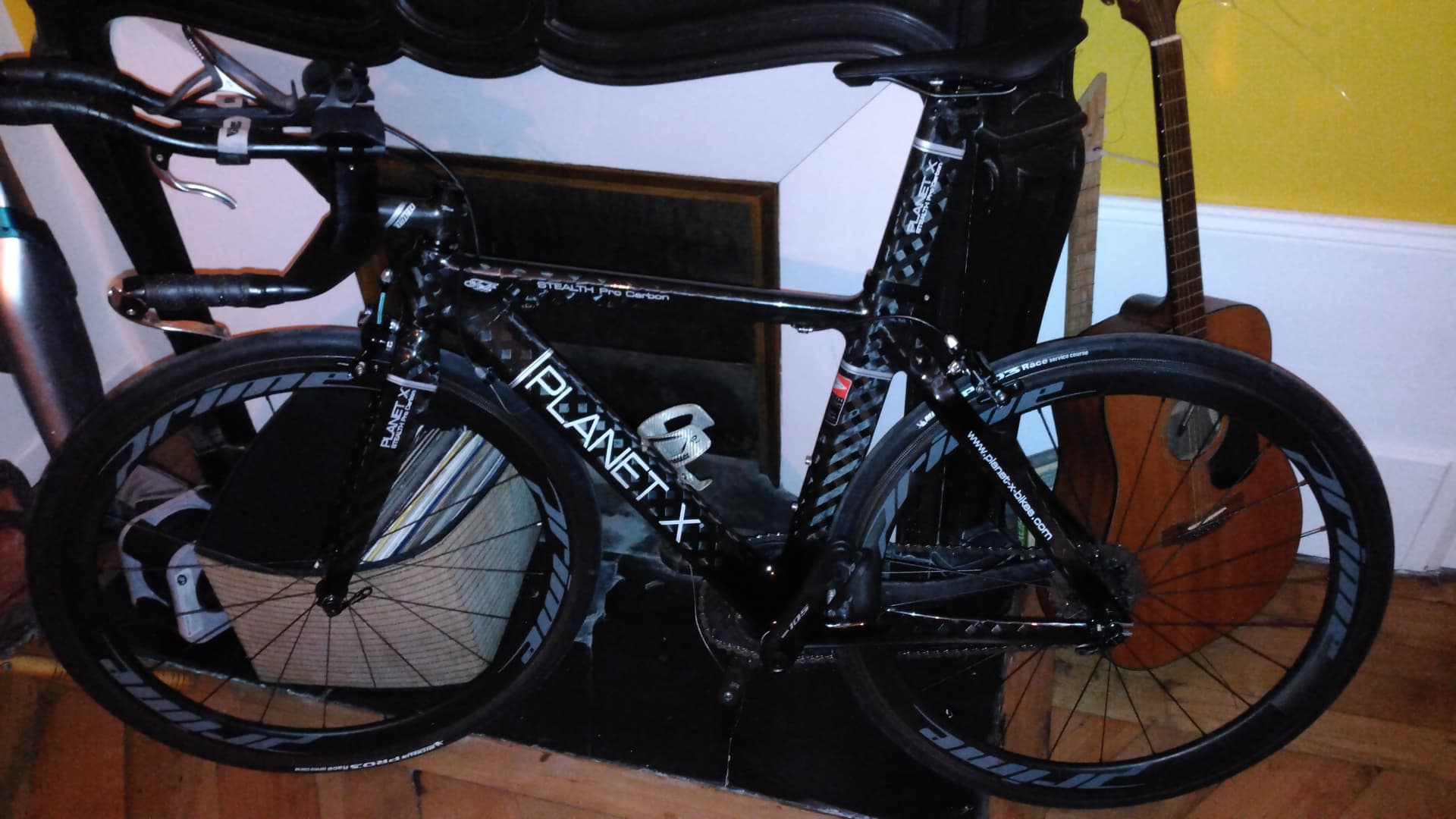

Four things jump out:
  1. Disc cover on rear $100
  2. Move the downtube cage to behind the seat. $0-$100
  3. New aerobar setup: ski-tip bars and angle spacers. Longer arm cups also help. $100-$300
  4. Bento behind the stem $50
Thanks, it helps a lot.
I ordered a New cockpit with more adjustability and ski-tip bars.
I move the bottle since I had the support.
For the wheelcover, not sure i could find it in France but maybe an old disc.
Is it usefull to take out the spacers behind the stem to keep the basebar Closer to the frame? (putting an inclined stem or more spacers behind the ski bars)
Generally risers are more aero than stem spacers (oval profiles vs a thick cylinder). That being said, place the base bar at the right position for cornering/climbing (typically where you would ride on the hoods with a drop bar), and then use the necessary risers to position the aero bars. Use the bento to smooth the airflow behind the stem.

It’s hard to see everything, because of the dark and busy background…
A couple things I would add to the above…
  • Aero front brake
  • Behind the seat bottles - they improve aero
  • I can’t tell about your tires. Are they fast?
  • Latex tubes
I’d just do latex Tubes, conti gp 5000 tires and 88 mm Chinese wheels front and back which are about $400. That will get you nearly all the way there compared to a $6k current gen tt bike having compared this myself.
I actually suspect you’re not losing a ton with that setup if you aero position is decent.
