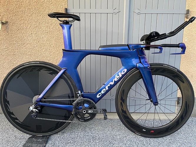

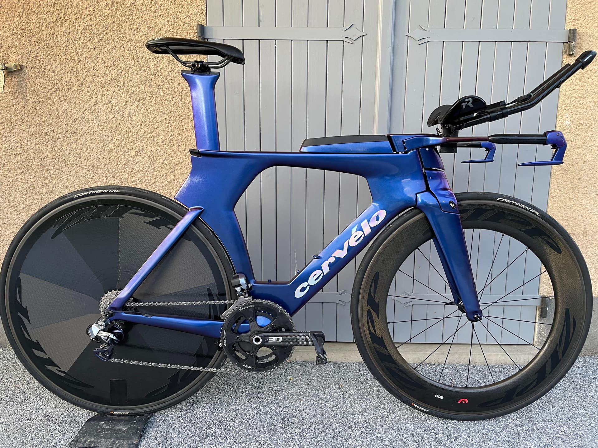

I confirm tririg alpha one compatibility, with custom parts (beard support and stem cover).

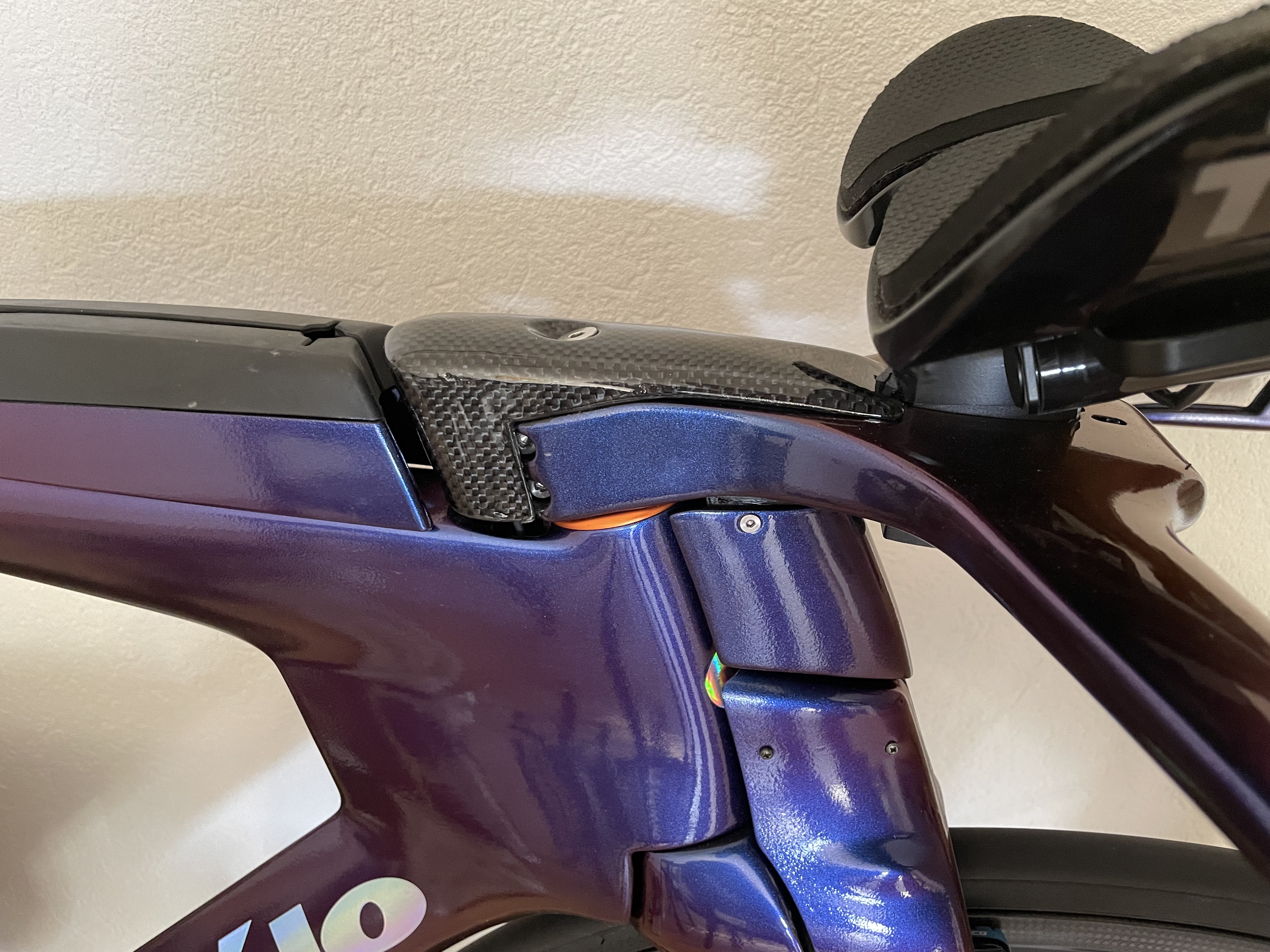

I made 2 custom parts on this build:
  • the beard support, 3D printed in ABS, screwed to the Alpha1 stem and holding the brake hose cover
  • the stem cover, in carbon fiber. I have made this part in carbon fiber / epoxy. I had initially made it out of 3D printed ABS but it was not hard enough, the brake hose would eventually break the part. So I 3D printed a mold and then made the piece in carbon fiber.

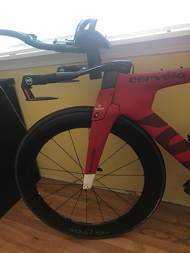

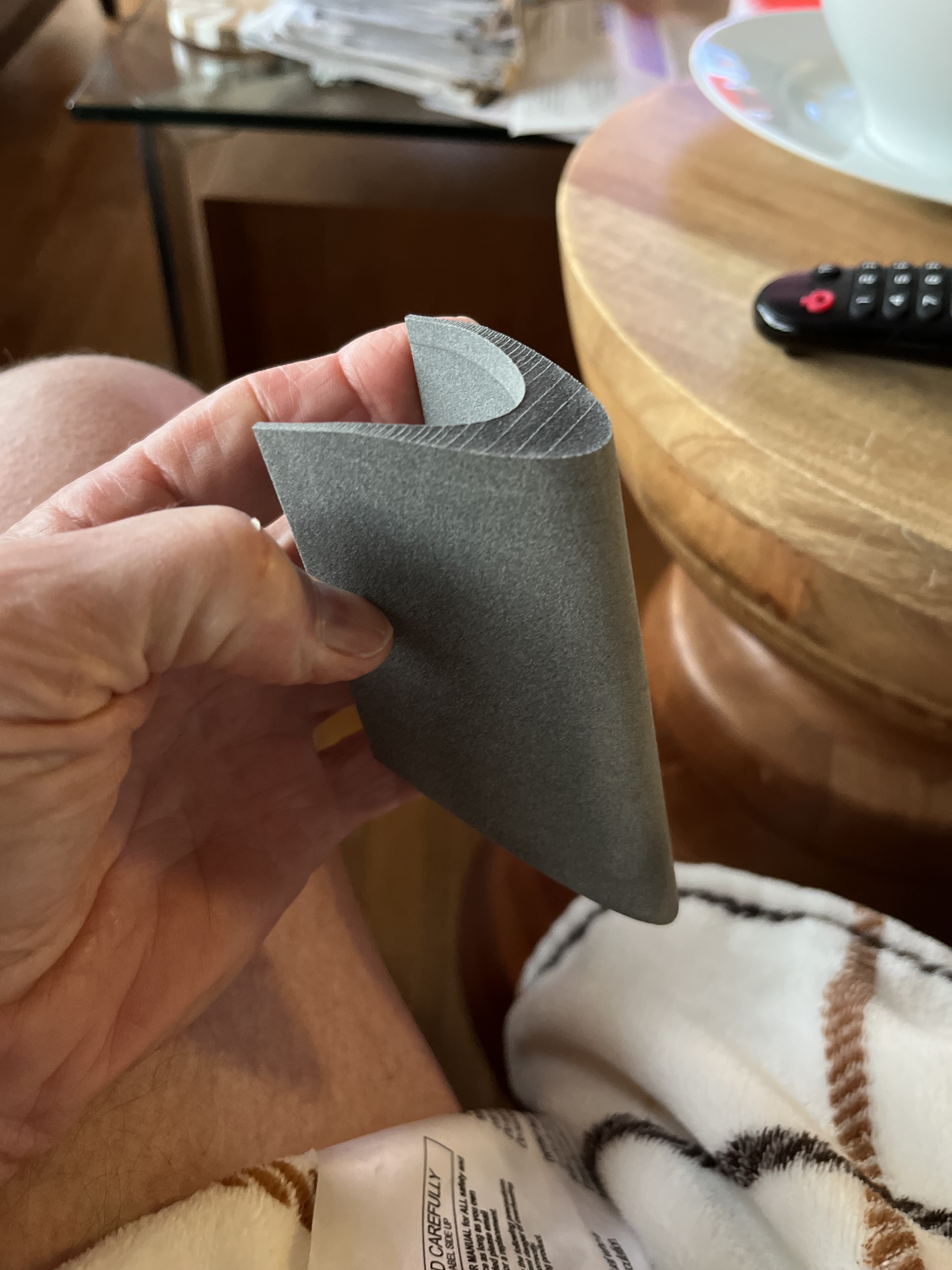

The Red P5 was my old bike. Nick gave me the cad file for the underside anatomy of the AlphaOne base bar so I could perfectly fit my nose fairing. Happy to provide you with extra printed nose or STL file to print your own. That looks like a size 51? My nose if for a size 54 but it can be trimmed down to size
