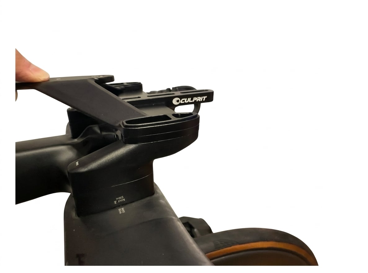

Dual bottle is going to require a bar from someone else (with the usual warning that PD hasn’t tested products from any other brand thus can’t endorse any non-PD setup). If you want adjustable tilt and rise - Culprit has already mentioned his product.
I just got my profile A3 bridge in stock and I also just got restocked on bta risers. so if you need a 2 bottle or 1 bottle solution that has adjustment, reach out.

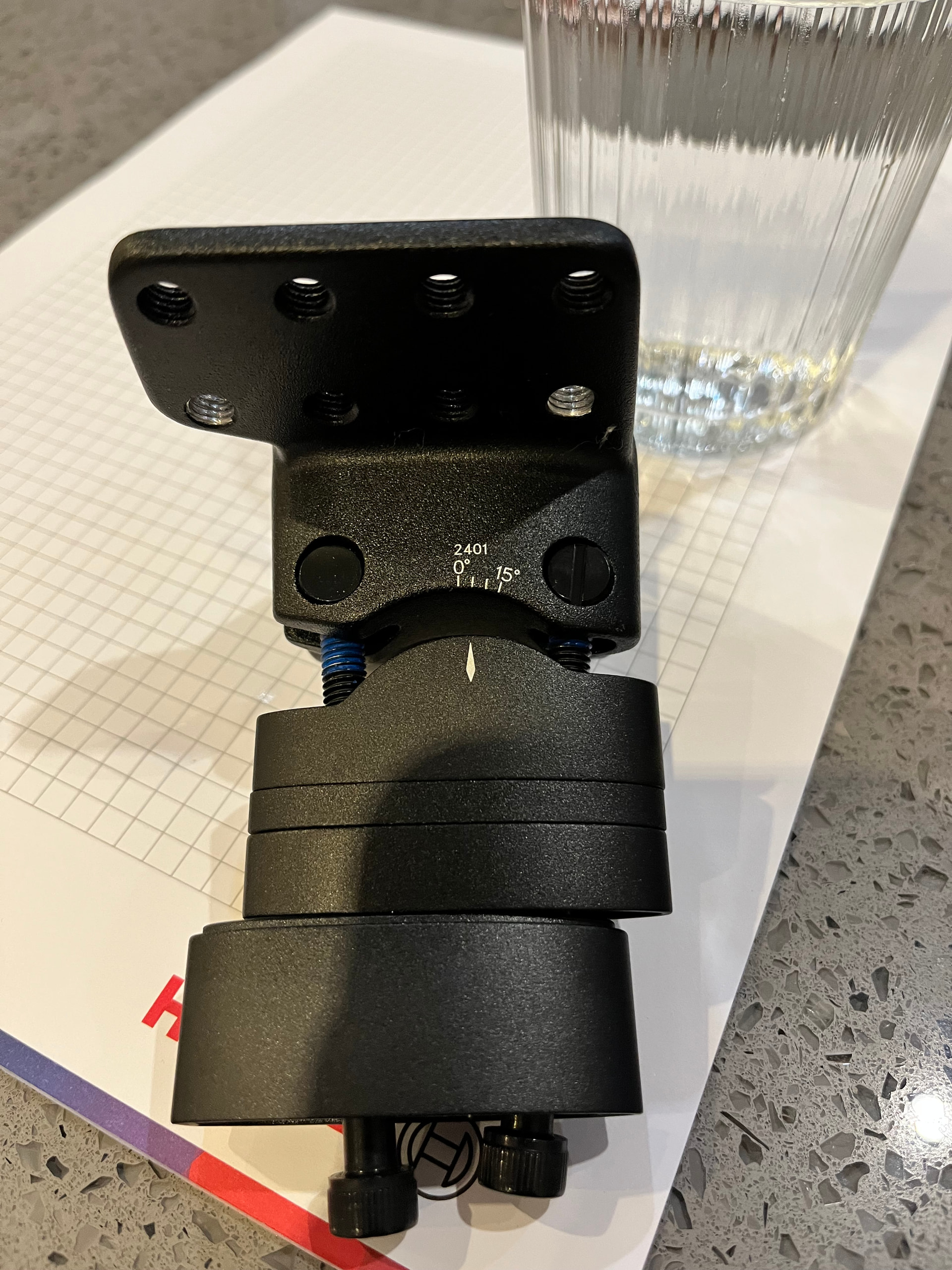

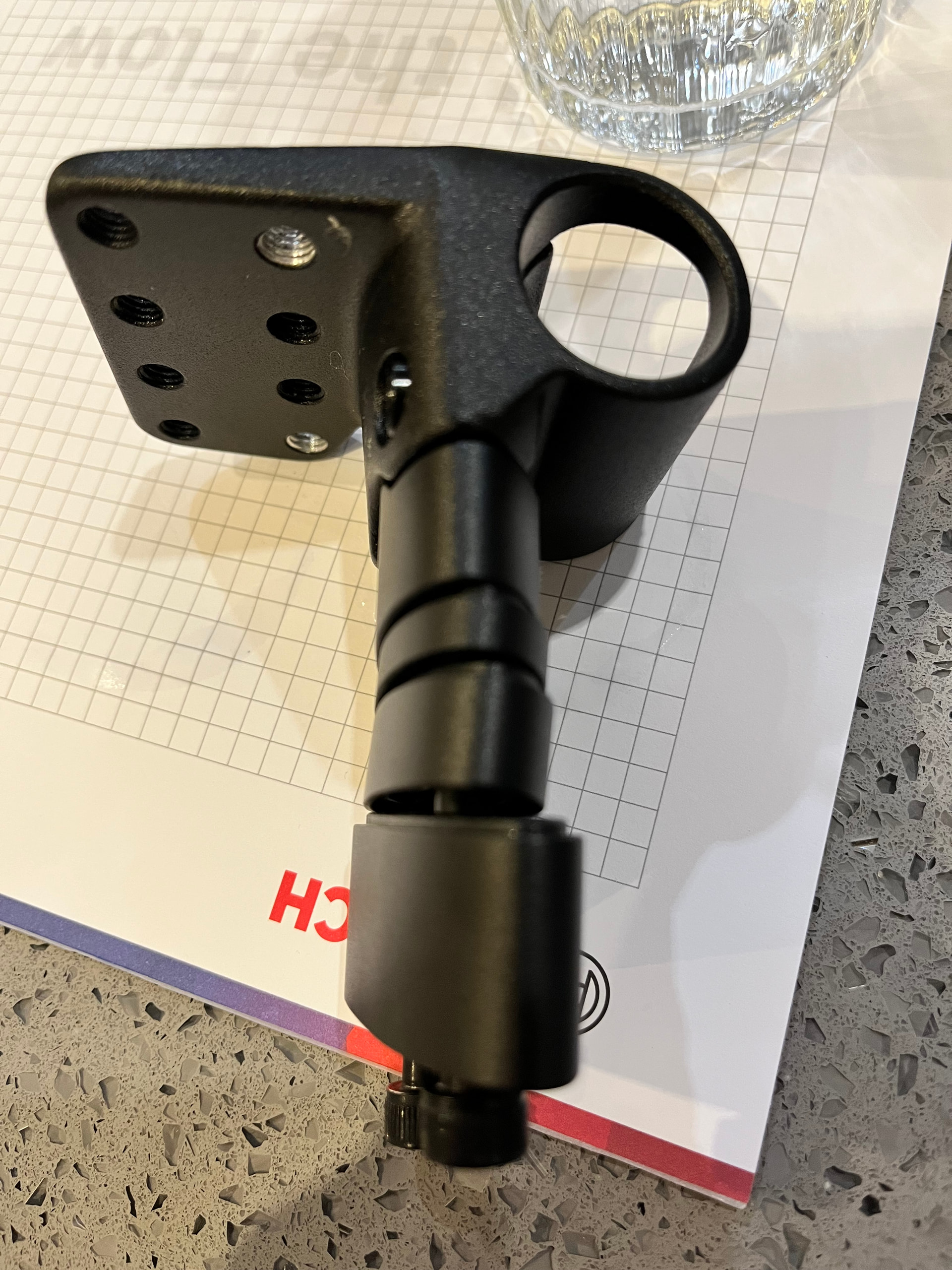

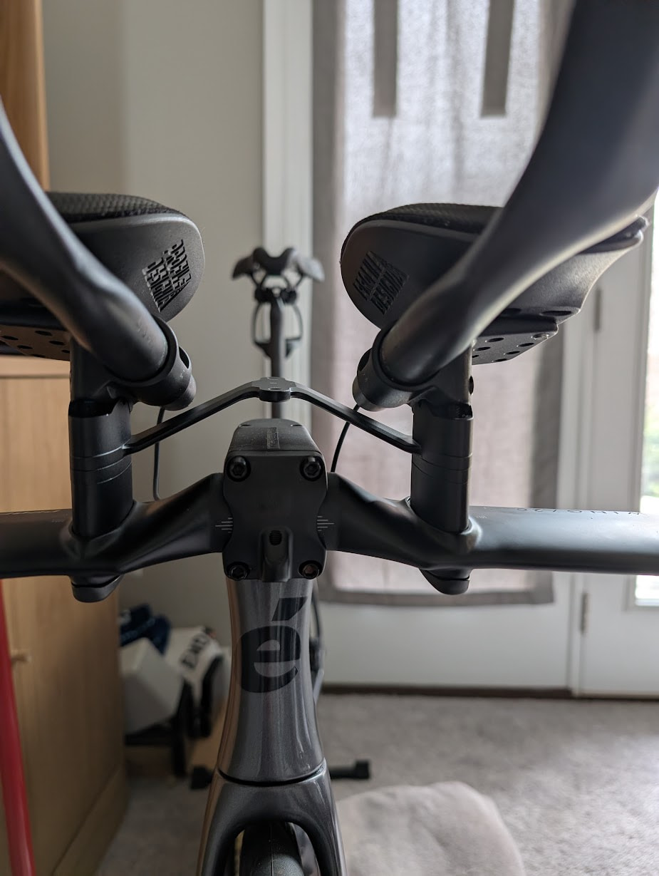

Hi Hive. Trying to fit different aero bars to my Canyon CF7. From these pics, can anyone clarify the following. I’m guessing the mount on my base bar is A3. I then have three decreasing height A3 spacers, an A3-A2 adapter and an adjustable bracket that holds the arm cup and the aero bar. I want to replace the bracket that holds the arm cup and the aero bar as my new aero bars are once piece - integrated arm cup and aero bar, although I’ll need the flat plate to bolt the new aero bars to. I’m after a clean and tidy solution that retains the ability to adjust the angle. Thanks, Pat.
Usually in these cases, the manufacturer would provide mounting systems for the various brands. See culprit, aerocoach for example. If it were me and the bolt spacing matched Id just slap a ASC pro bracket on it live with it, safety risk be damned. Cyclenuts above can’t claim every non profile bar would be safe because profile is only responsible for their products being used for their designed purposes.

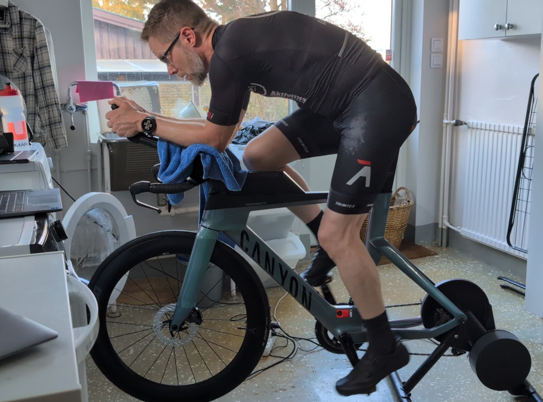

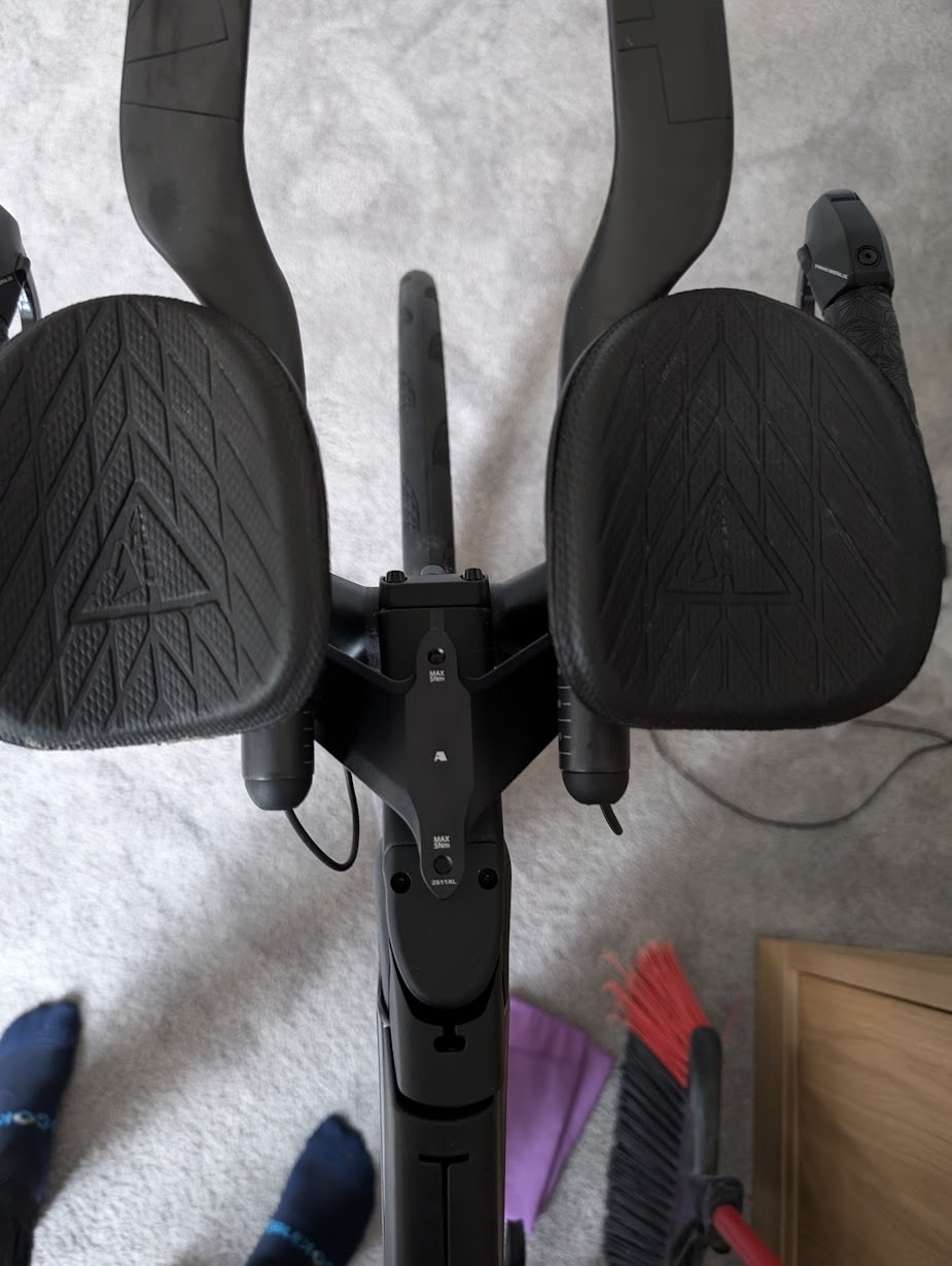

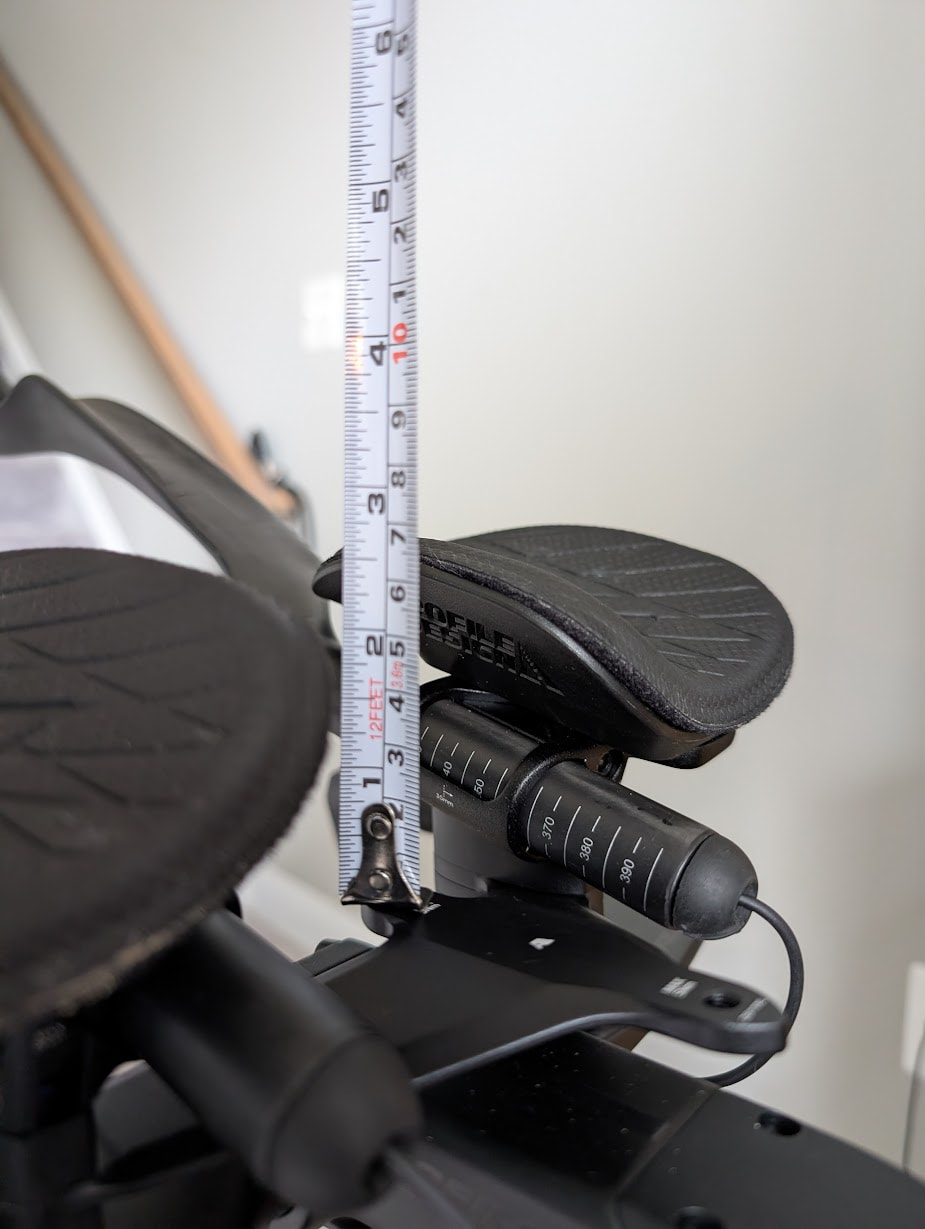

Just got my new Canyon Speedmax CF 7. I have put on the spacers that came with the bike (20+10+5mm). From bikefit ideally I should have 25mm more stack, I also want a bta solution and trying to figure out my options.
The high rise kit. Gives me enough stack, and the required bridge. But can the bridge be used for bta? Not sure what the hole is for.
The angle spacer and bta bridge. I like the feeling of a bit more angle (have the max 15 ° now). I assume there angle spacer adds stack as well? I have read a bridge is required/recommended when stack is 40mm?

Yes, the tilt booster would add a bit of stack, but more tilt takes it away, so you don’t gain much in the end. Unless your pads are all the way forward. Yes a bridge is required over 40mm
Get an A3A low riser kit to gain extra risers, buy the longer bolts required for higher stack and an A3A BTA bridge.
