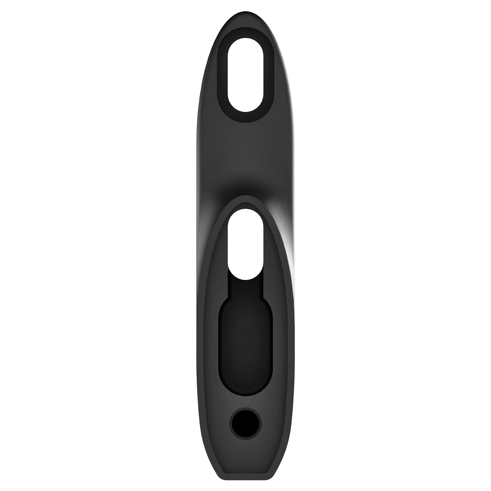

I see the ASC pro brackets have a 5mm or 15mm offset, by looking at it it seems that the 15mm covers the same range as the 5mm with additional ± 10mm adjustments, is that correct? Hope that the suggested price goes down too ![]()
The asc pro width positions are discrete. The 15mm bracket does the extremes, narrowest (130ish) and widest (200ish). The 5mm bracket does the middle widths (150 and a bit over 170).
There is no overlap in what can be achieved, thus the two brackets.
As for price. Costs from vendors keep rising so its unlikely anything will fall. Can’t make enough of any ASC range products to meet demand so there won’t be much price competition among dealers either.
