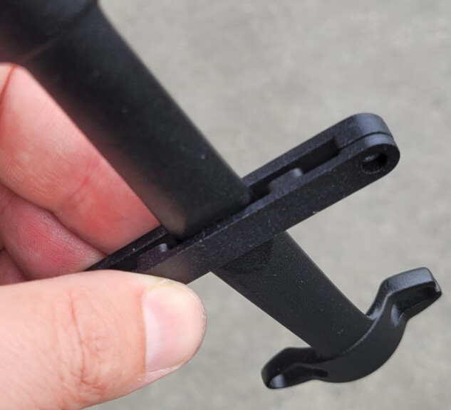

Got a pic of this?
The bottle cage bolts hold it together
On a Wing20C+ this bridge will sit above the curved adaptor plate

Sorry I wasn’t clear. Do you have a pic of the zip tied garmin solution for the asc bars? I couldn’t figure out how to get that to work.
Garmin mount or BTA mount?
This is the BTA that isn’t released yet and not available for a few more months
Designed to fit close to the front of the bracket where the ASC extensions are still round. Haven’t fitted zip ties as my fit bike doesn’t need a hydration system

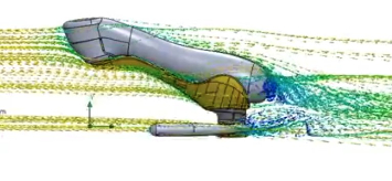

It’s not 3D printed as was stated in the GTN video (that was the only mistake), instead moulded carbon which means it’s lighter, stronger and much cheaper than the rideable 3D prints we did. My 3D printed prototypes weigh nearly twice as much and cost the same to make as the MSRP of the carbon production version. Ti prints would be better on the weight front, but wouldn’t fix the cost problem.
In first run CFD it showed 75s faster at Kona than a clip on and basebar. That translates to 5.7w at 50kph if you want to compare to other claims.
I’ve got the team working on doing some better comparative data.

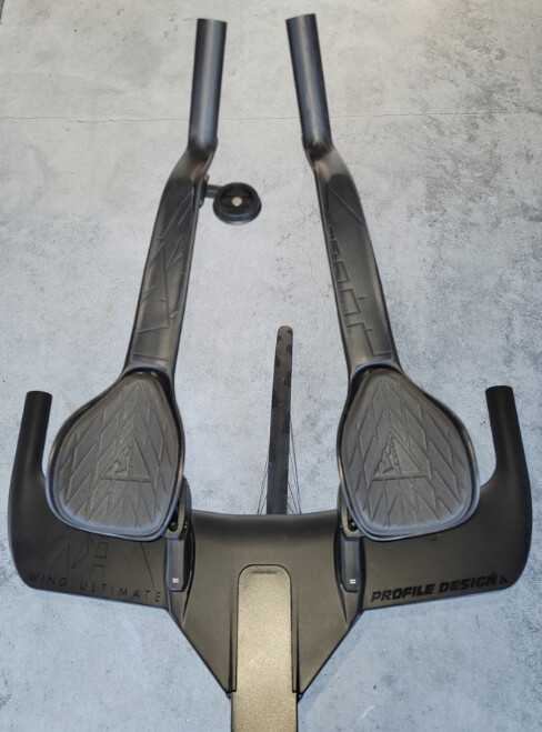

Key points
  • only for PD A3 or A2 basebars or bikes that use those platforms (BMC, Canyon, Cube, Orro, Wilier)
  • 3 lengths
  • 2 brackets to give 4 elbow width positions and 2 reach positions
  • 15deg built in angle, range 10-25 with wedges
  • Reach extender in the GTN video is a separate product that adds 30mm
  • bolt on garmin mount available
There is a rudimentary info page on the EU website https://www.profile-design-eu.com/products/asc-pro (spec table is wrong, looks like it’s from the 43ASC)
The fit range is limited compared to other PD products, there is an unavoidable tradeoff between minimising frontal area and adjustment range.
That is the widest pad position at a bit under 200mm, narrowest ~130mm (yes I know the wheel is not straight)
The design is oriented towards the positions typical of the pointy end of TT and Tri - fairly well forward, tilted, narrow. It is not going to suit every rider, I just want to make that clear at the beginning. PD has other products that can accommodate a far larger range of positions. If you have a bike that it fits on and it can hit your fit numbers it’s an easy path to an optimised front end.
*no one would claim that my uninspiring effort at an aquabike in January was serious competition. And those were the heavy prototypes.

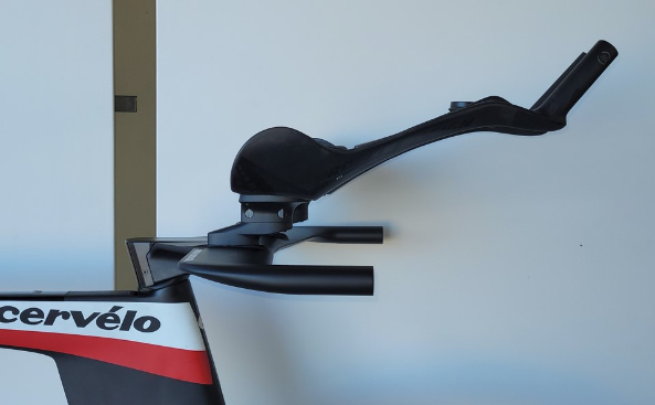

Any chance Aeria Ultimate Race Bracket Kit can be used instead of the top part of the J4/J5 bracket?
I’m on J4 now and despite it works I’d like to have something smaller - I do not need an additional width adjustment. Or will it be safe to saw off that extra centimeter of the bracket?
