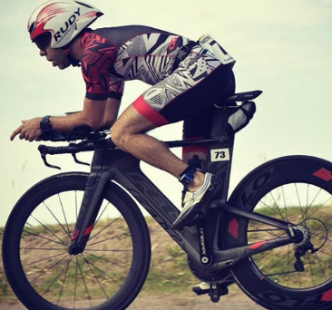

You’ve got a very workable position that really doesn’t need much in terms of stack height changes but more in “postural” changes. IE, if you properly turtled your head and shrugged your shoulders your current stack height is fine. You’d need more reach to accomplish this comfortably, and probably a little bit of tilt. You could even come “up” some in terms of pad stack in order to effectively lower your head which I know can be a bit counter intuitive.
After seeing this pic, I’m comfortable saying that you’ll be fine on a 51cm. Heck, with adding 15mm additional reach to your current numbers, which I think you absolutely need, you could hit a 54cm P5d with the flexibility to go 20mm lower, which I don’t necessarily think you need. The 51cm P5d should be perfect for you.

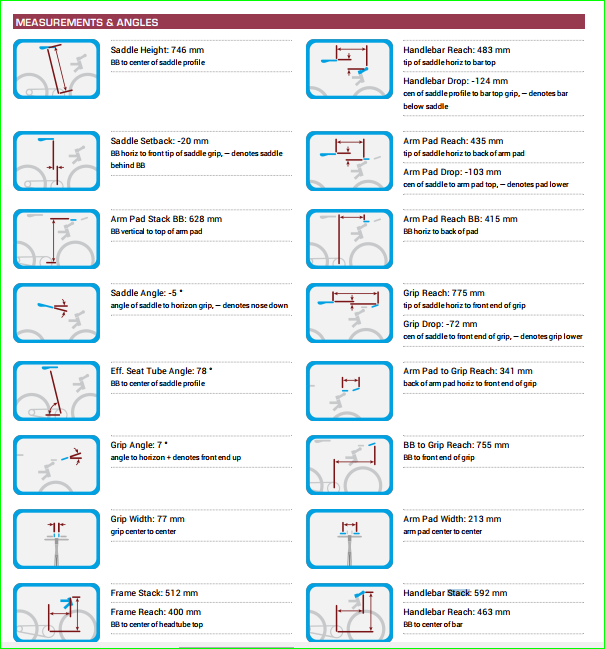

Hello Eric,
I’m looking for a Cervélo P-Series, but I don’t know if my frame size is a 51 or a 54.
I’ve got 178 cm and 81 cm inseam.
Thanks
The Bike Fit in my Argon 18 E-117 Tri+
hi, thanks for reaching out.
With a Pad Stack of 628mm and a Pad Reach of 415mm you’re in the very upper left quadrant of a 51cm P5d, and similar on a P-Series, but you’re a bit unorthodox, sort of upright and I’d be concerned that once you grew into your fit you’d be needing a 54cm. I haven’t seen a picture of your fit obviously, but I’m guessing with more saddle and posture coaching you might move toward the center quadrant of the 51cm.
The great thing about a P-Series is that you can put on a shorter stem and the cockpit is very adjustable to begin with. I’d go with a 51cm using extension and pad risers to get you to 628mm and not stem spacers. If you’re thinking your position is one that will evolve and that you’ll grow into, we can talk about what it would take to do a 54cm bike.
Make sense?
Eric
