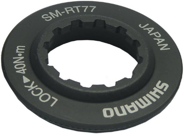

I’m a fan of these lockings from Shimano. They have more clearance for the TA end cap compared to the second option. The install with a BB tool compared to the Freehub locking for the second option.
First Option:
https://www.amazon.com/...615135265&sr=8-1
Second Option:
https://www.amazon.com/...15135265&sr=8-19
When in doubt, with 12mm thru-axles, definitely go for option “B”. Option “A” will not work with some fork designs that have tight clearance in the brake mount area. With bikes that have a 15mm front axle, always choose “A”, as you won’t be able to fit a tool in between the fat axle and the lock ring (unless your hub has pull-off end caps that you can pull off with the lock ring mounted).

I will also say based on experience that option B has problems even with certain 12mm thru axle hubs. I have a set of wheels with with DT Swiss 350 hubs where option B won’t work (I can’t fit the tool) and a set of wheels with DT Swiss 240 hubs where option B is totally fine.
Definitely true, but as a general recommendation I still stand by option “a” for 12mm. In the few cases it doesn’t work, you find that out really quickly when you just can’t mount the darn thing. When option “b” doesn’t work, well… I’ve seen a couple/few forks that had to be thrown away as a result. It turns out that folks these days more or less just assume that anything that is rubbing down around the hub area is probably their disc rotor, never mind that black powdery stuff that’s suddenly coating everything…
