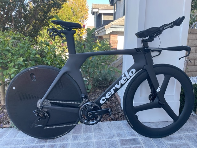

I’m in the final throes of building up a P5D with DA Di2 12sp. It’s fully wired and requires an adapter that lets the old (11sp) wires up front talk to the new (12sp) wires in the back. Shifters are 1-button and there is no “press both to shift the FD” like SRAM so shifting is full syncro - no option to control FD shifts. This page has all the info you need: https://bettershifting.com/build-a-12-speed-di2-time-trial-triathlon-bike/
I’m in the final throes of building up a P5D with DA Di2 12sp. It’s fully wired and requires an adapter that lets the old (11sp) wires up front talk to the new (12sp) wires in the back. Shifters are 1-button and there is no “press both to shift the FD” like SRAM so shifting is full syncro - no option to control FD shifts. This page has all the info you need: https://bettershifting.com/...rial-triathlon-bike/

One red flag though… you never, ever take a photo of your bike with the chain in the inner ring :S
I blame the syncro shift!
Also build is incomplete - will either be replacing Ascalon adapter with the low-stack version or cutting the monopost. Bike isn’t yet ready for its official photo shoot, just look at that travesty of exposed Di2 cables in the front.
Tidy, what wheels are they?
