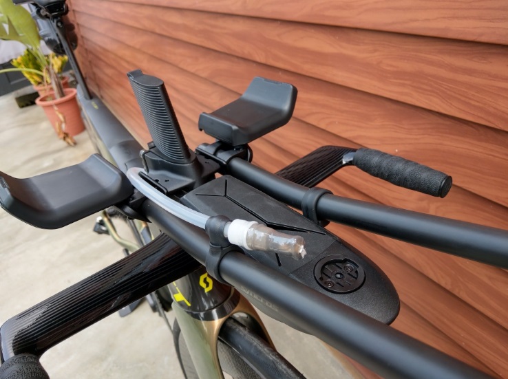

Brakes on the extensions is, umm, interesting. I can’t see if those are stack-able spacers on the aero bar monopost, or if you just cut it to size once fit
That rear of the monopost clamp looks super bulky and unaero. As does the back of the nutrition storage. Looks and reminds me of how blocky the rear of the S-Works cockpit is. Seems like it could have been made for more streamlined
It looks less ugly from the side than what I saw in the previous pictures, but that front hydration system still looks out of place or completely the wrong shape or something. I would’ve hoped it would be something somewhat integrated like on the Canyon Speedmax/Cube Aerium C68/Profile Design Aeria Ultimate.
Brakes on the extensions seems like an accident waiting to happen, at least 80% of people don’t descend in aero bars… And I like the mono riser from a visual perspective but it seems like a pain having to cut that.

also the arm cups look very flat and its hard to be sure from those pics but i suspect not readily replaceable with aftermarket options as they look to be integrated with the connection to the mono-riser. similarly, it doesn’t look like you can adjust the width of the extensions (probably constrained by the bento anyway).

The absence of hoses, shifters and chain makes me thing someone just stuffed the levers in there.
At least that’s what I’m hoping.
From the look of the clamp fixing I’m guessing the bracket has grooves to match those on the tower for security. Having a tower that the bracket moves on would be their way of getting around the patent issues for mono risers.
They finally solved the riddle of getting rid of the chain and pedals, nice!
The front end setup is clearly designed to have the brakes in the normal position and an etap groupset. You can see where shifter cables can be routed out the back of the extension but there doesn’t appear to be an obvious place to hide a junction box. The lack of complete front end integration probably helped them get around patents related to the riser on the front end but means the bike is designed for etap.
The front end system also makes it potentially easier to live with fully hidden hydraulic hoses as you can adjust the fit without messing with the hose. You may also has enough room to remove the bar for travel without disconnecting the hoses which would be a win. The down side is some serious creativity may be needed to wiggle the bars and frame in a bike bag without disconnecting the hoses. The riser poses a significant geometry challenge in terms of getting the bars the right plane to fit into a bike box.
I’m not seeing any obvious way of adding tilt, but I guess there could be something in the clamp contraption to allow that?

Is that monopost meant to be cut?
You know…if the brakes were hydraulic RIM configuration, it would actually be possible to run levers at BOTH the extensions and the base bar (“Y” configuration on the levers to the calipers).
But, with hydraulic disc (with the necessary fluid reservoir) configuration, that’s not possible…sigh…
The grooves on the base bar are interesting. They may actually be slots that go all the way through the bar. It’ll be interesting to see what the claimed advantage is.
Agree with cyclenutnz that the mono post is grooved and meant to be cut. I don’t see the ability to tilt, though nowadays you can just replace the arm pads with cups and get upturned extensions to take care of that. Mantis is the future only limited by how high you can bring your hands up to see down the road.
Basebar “grooves” look like cosmetic striping to me…
