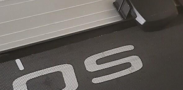

Been using the Runn for a few days now. I have a Sole F80 so when I hit 10.0 for example I dont know exactly how long it takes to ramp up. Now I’m using with Zwift and seeing the actual speed as it increases and then reaches that level. My 15% incline only goes up to 12% according to Runn, probably accurate. I really like that elevation data is on my Zwift Strava now so I get credit for all the climbs. I set 0 at 1% so the Runn app shows 0% treadmill as -1, however Zwift/strava stats dont show decline so my file just shows a constantly growing slope, even if I go down. Overall really happy to have accurate speed, ditching my old milestone pod.
Very interesting!
Do you think this would work on a woodway? Am worried about the adhesives sticking on the slat style decks…
Not sure, my F80 is a 2012 model. Attached a photo, you can see a sticker on the belt. None of them have come off so far…
