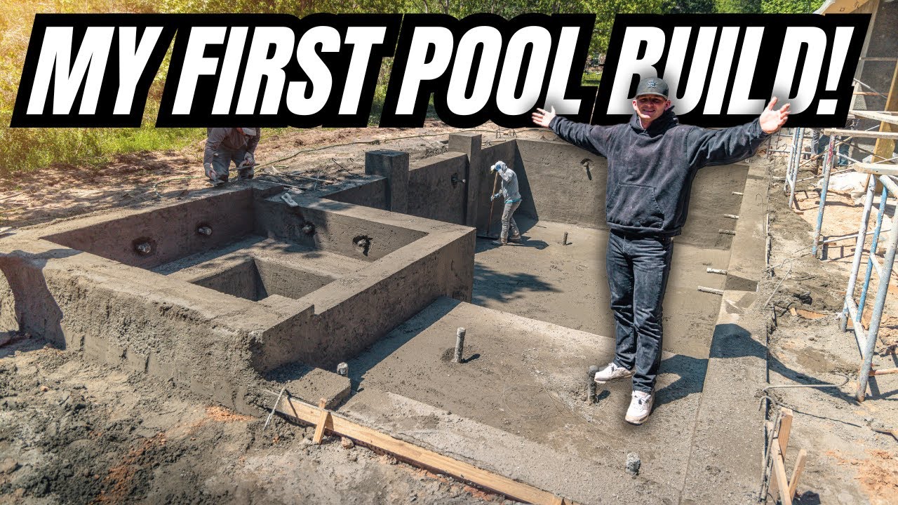

What’s the soil like there? It looks like the outside of your walls weren’t formed but poured directly against the soil, is that correct?
How many concrete pours was this done in?

Yes, they dig the outline, shape, depth of the pool, then rebar it, and shoot the concrete (gunite or shotcrete depending on the builder)

Cool, that’s interesting. We don’t really use that product here outside of commercial applications, excavation retention etc. We also don’t have a particularly big pool industry for obvious reasons.

Yeah, the thought of shooting structural stuff like that makes me uneasy. I can’t see how you would get good consolidation, not have air pockets without vibrating, how strong it would be with no aggregate and so on. Even how wall crews shoot walls and pool floors like gmans had me raising my eyebrows a bit.

Most “nice” pools built in warmer climates are done with the shooting process. It also allows for whatever design imaginable which a prefab fiberglass or poured concrete shell do not.
