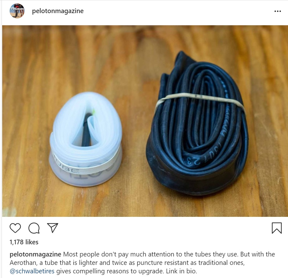

Just saw this on the socials:
I hate latex tubes*, but love how fast and smooth they roll. Wonder if this would be a worthy rival? Article says the thermoplastic tubes roll similarly to latex, but I wonder how similarly? And the puncture resistance seems better. So are plastic tubes the future of tubed racing wheels?
