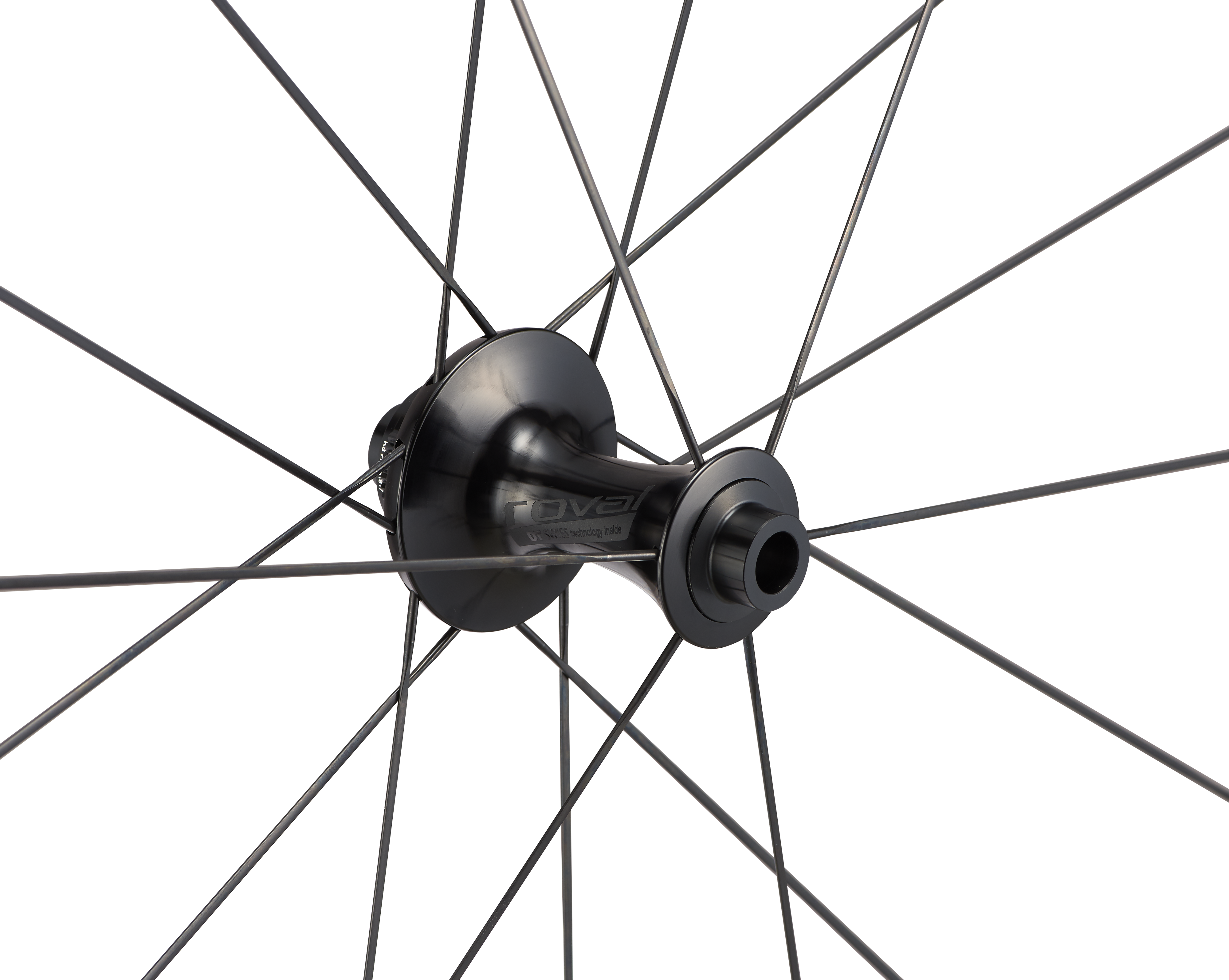

No, it just seems odd that nearly all the TT disc wheels appear to be poorly designed for their task. It’s weird because… don’t people still care about aero? Is anyone testing them? I understand that disc TT bikes are the thing now, and pretty much all you can buy, and that won’t change anytime soon… but no one even seems to be trying to make them as good as they could be.
The main task difference is that the front disc wheel needs to handle braking torque. That might be a lot of torque too when braking is involved, but I question whether the potential of disc brakes is wasted on a TT bike. I’ve personally done an endo in a race when I was trying to stop to avoid a crash. That was with old Campy Record sidepulls, that absolutely suck for braking power compared to modern caliper brakes. But still if it’s properly adjusted and you grab them hard, a forward endo-faceplant is the result… just physics. Where it’s nice to have powerful brakes is when you need to use them a lot for a long time… and having the braking force not heat up your rim/tube/tire is sensible. So on MTBs and maybe road bikes it makes sense. On TT… not so much…
Sorry, I’m drifting. The task is making the TT disc front wheel handle braking torque while being as aero as possible. Torque is lever arm and force, simple enough. So triplet lacing with a big flange with tangential lacing on the disc side will do this the best, with the least stuff churning in the breeze. And yet I see 24 spoke small flange front hubs even by the big manufacturers. Zipp uses 20 spokes, but still small flange hubs… and they even radial lace the non-disc side even though the hub is beefy enough to transmit a good amount of torque.
The only sensible one I’ve seen is the Specialized Roval. Triplet lacing with a big DS flange, and radial on the little NDS flange, 14-7. Maybe not perfect, but at least they put some thought into it, while I’m not sure what the other companies are doing… but it looks like they are using off the shelf MTB hubs…
https://assets.specialized.com/i/specialized/30022-590_WHL_RAPIDE-CLX-TUBELESS-SATIN-CARBON-GLOSS-BLK-700C_FRONT-HUB?$scom-pdp-product-image-zoom$&fmt=auto
