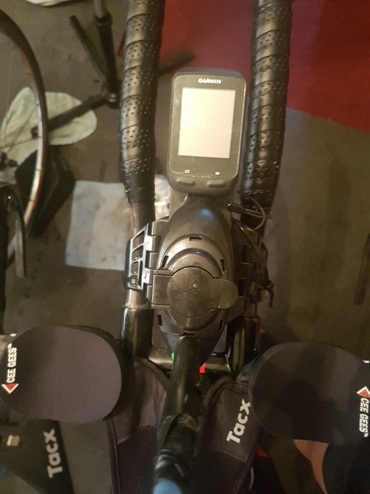

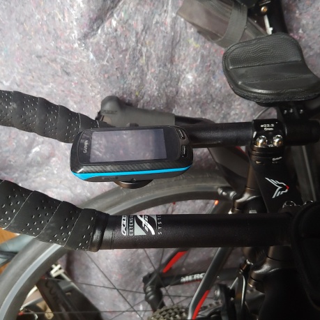

I solved the problem by getting a Garmin mount that is meant for aerobars. I informed at LBS but they only had a €75 mount. Bit steep for just a bit of aluminum. So i ordered one online from China for $15 which works great. So i can use that for shorter races when i don’t have my bottle mointed in the aerobars.
When i do have my bottle mounted i attach my Garmin to the bottle itself using the standard handlebar mount and a rubber band. Sits on there quite rigidly so probably pretty potholeproof.

Photos of my $15 Garmin mount.
