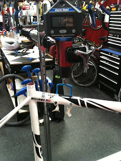

Here are the pre weights of the bikes:
http://4.bp.blogspot.com/-SQeDoPZ2rqk/ULLUiXO-SqI/AAAAAAAAB1Q/8OX4I4V0aic/s320/IMG_0403.JPG
2008 Cervelo P3 56cm Frame, 1.3kg
http://1.bp.blogspot.com/-__GVHWMDca4/ULLVdkSDb-I/AAAAAAAAB1g/1RHAhQ-ukZw/s320/IMG_0404.JPG
2009 Cervelo R3 58cm Frame, 0.96kg

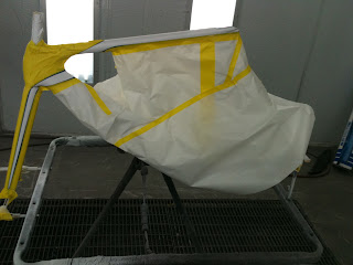

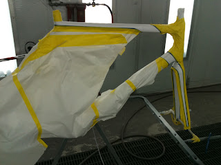

After the base layer was applied we then taped out the red stripes, below are pictures:
http://2.bp.blogspot.com/-OuldZJRLZsc/ULLWHoziFvI/AAAAAAAAB1o/pdJVWybCvuM/s320/IMG_0416.JPG
The R3 prepped for the red stripe
http://2.bp.blogspot.com/-RnsEEi61GGg/ULLWKjbOFUI/AAAAAAAAB1w/c5Cx-Xozi0A/s320/IMG_0417.JPG
The P3 prepped for the red stripe

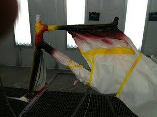

Once the red stripes were sprayed we waited for it to dry and then removed all of the tape and paper. We then laid out the black stripe over the red paint and sprayed it. The taping process was the most time consuming and spraying 3 different colors made the process quite long. But don’t worry it was the middle of the summer and hot, so of course we stayed cool by having a few beers :wink:
http://3.bp.blogspot.com/-DEtd-iI2_Oc/ULLXOl28W9I/AAAAAAAAB2I/fqbKxFSvIuk/s320/IMG_0421.JPG
The R3 with the black stripe painted

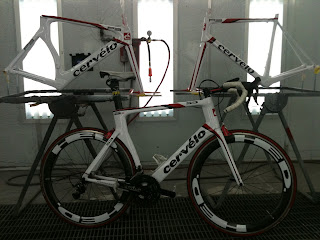

Here is a picture of the R3, P3, and S5 once they were completely painted

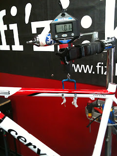

Now that the paint and decals are complete back to Fun Sport Bikes. I wanted to get post weights, so below are the results.
http://2.bp.blogspot.com/-LmqRgHp0L7g/ULLbNgiMKUI/AAAAAAAAB3M/PnaHwQJ7kU4/s320/IMG_0441.JPG
Cervelo R3 58cm Frame, post fresh paint job: 1.01kg = .05kg added, so 50 grams… not too bad

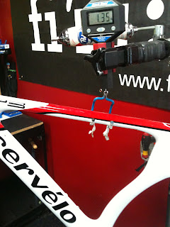

http://2.bp.blogspot.com/-T-eX7wiAAfw/ULLbQkMHcCI/AAAAAAAAB3U/i5bRhWGoERw/s320/IMG_0442.JPG
Cervelo P3 56cm Frame: post fresh paint job: 1.35kg = .05kg added, so the same as the R3, 50 grams.

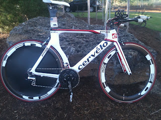

http://4.bp.blogspot.com/-sFH-K1vVYFU/ULLd4qwTs-I/AAAAAAAAB38/qqlTXVIGyrU/s320/IMG_0564.JPG
The Finished R3 in race setup
