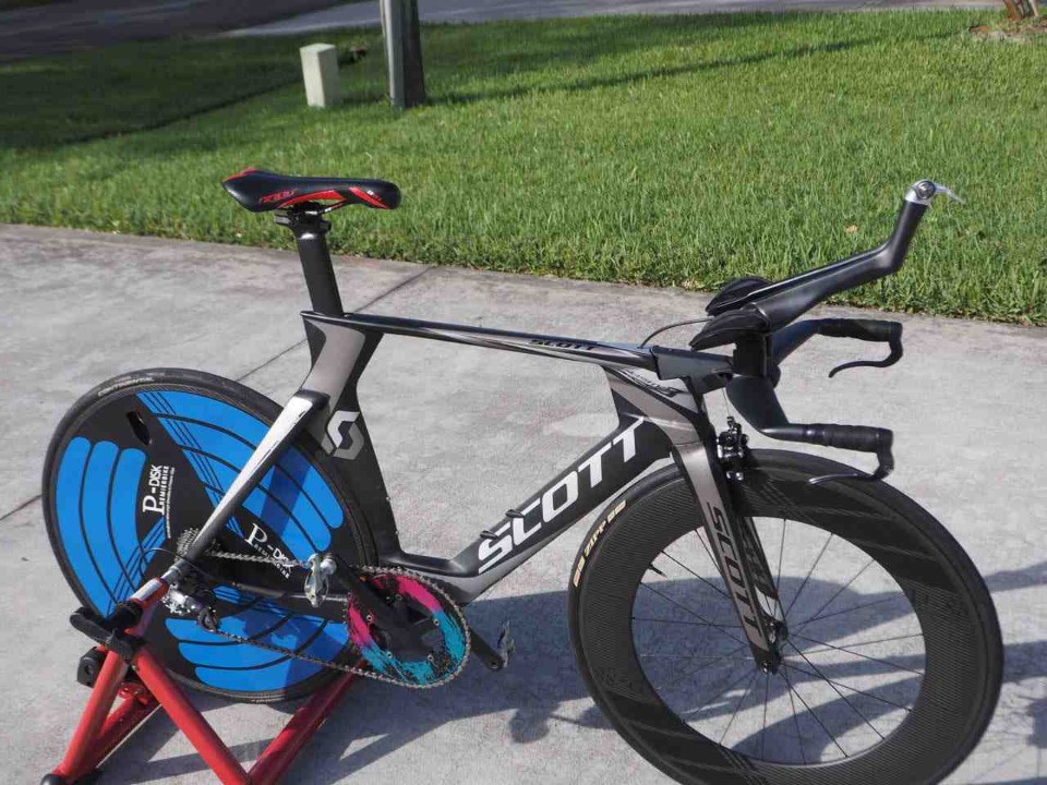

My summer project

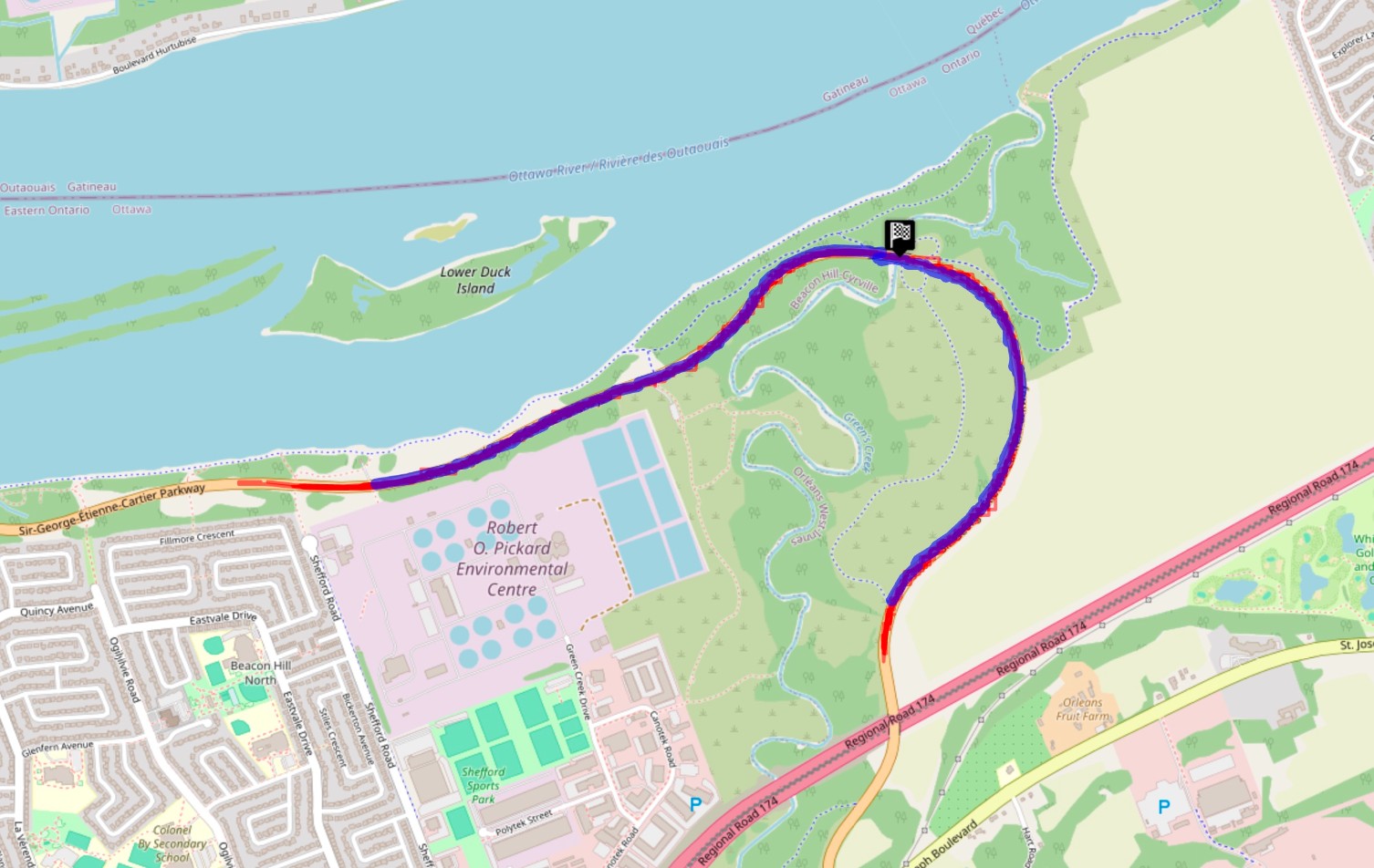

I have done baselines in 2 locations since I move from one place to the other frequently.

My plan was to start with the stock PSeries and benchmark it against my Plasma. Done.
The Pseries was slower BUT tires were not identical and there were small elements I wanted to change to make them identical. Slowly, evetually ending up in what I thought would be the end configuration. I used a Giro Aerohead for all these tests.
I had tons of rides and good data, very reproducible day to day which is key to this experiment. I was well on my way
