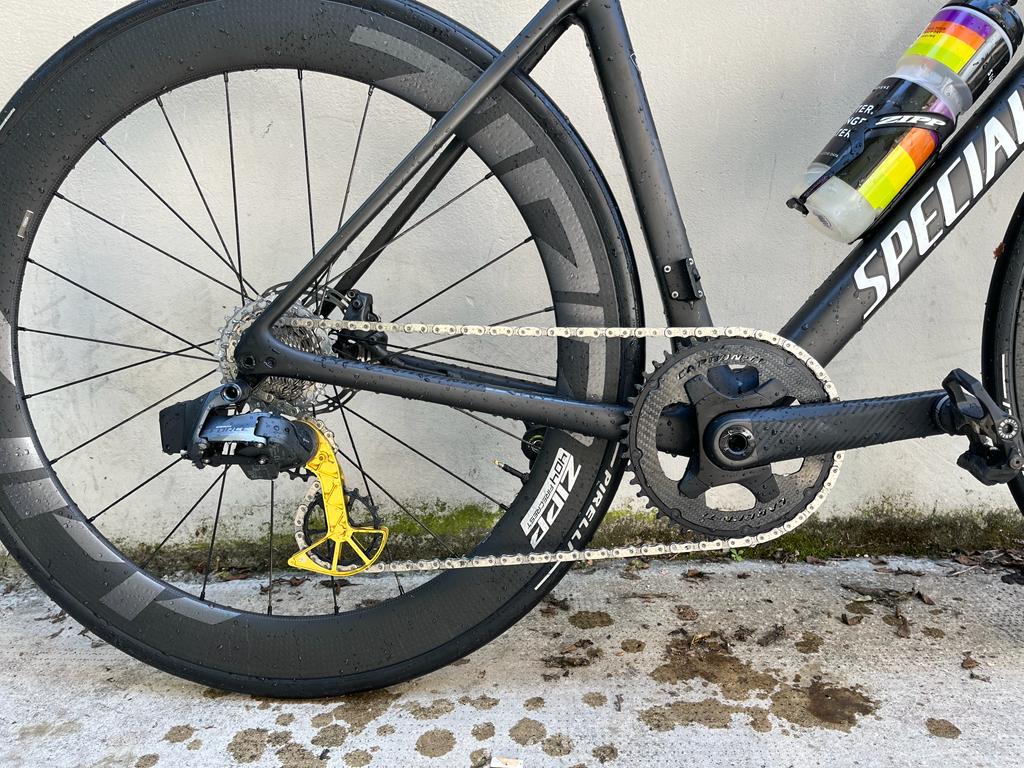

This is my solution with my Force Groupset
(https://i.postimg.cc/xdvkwjJj/Immagine-Whats-App-2023-06-21-ore-09-58-54.jpg)](https://postimages.org/)
Thanks,
I think I’ve got a better understanding of the whole crank / chainring setup now.
The crank arm themselves can be separated from the spider (with Red and Force using the same 8 bolt setup for the power spider - which is a 4 bolt setup to the chainrings) - so from my perspective I can for now just replace the chainrings and keep the force cranks - and then later I can swap out just the cranks for something else later.

Pay only attention that your Carbon Ti chainring have 107 bcd (bolt circle diameter) because I think that SRM Carbon TI chainring have 110 bcd
https://onlineshop.srm.de/it/shop/powermeter-it-2/strada/origin-strada-carbonio/
Thanks - good spot!
