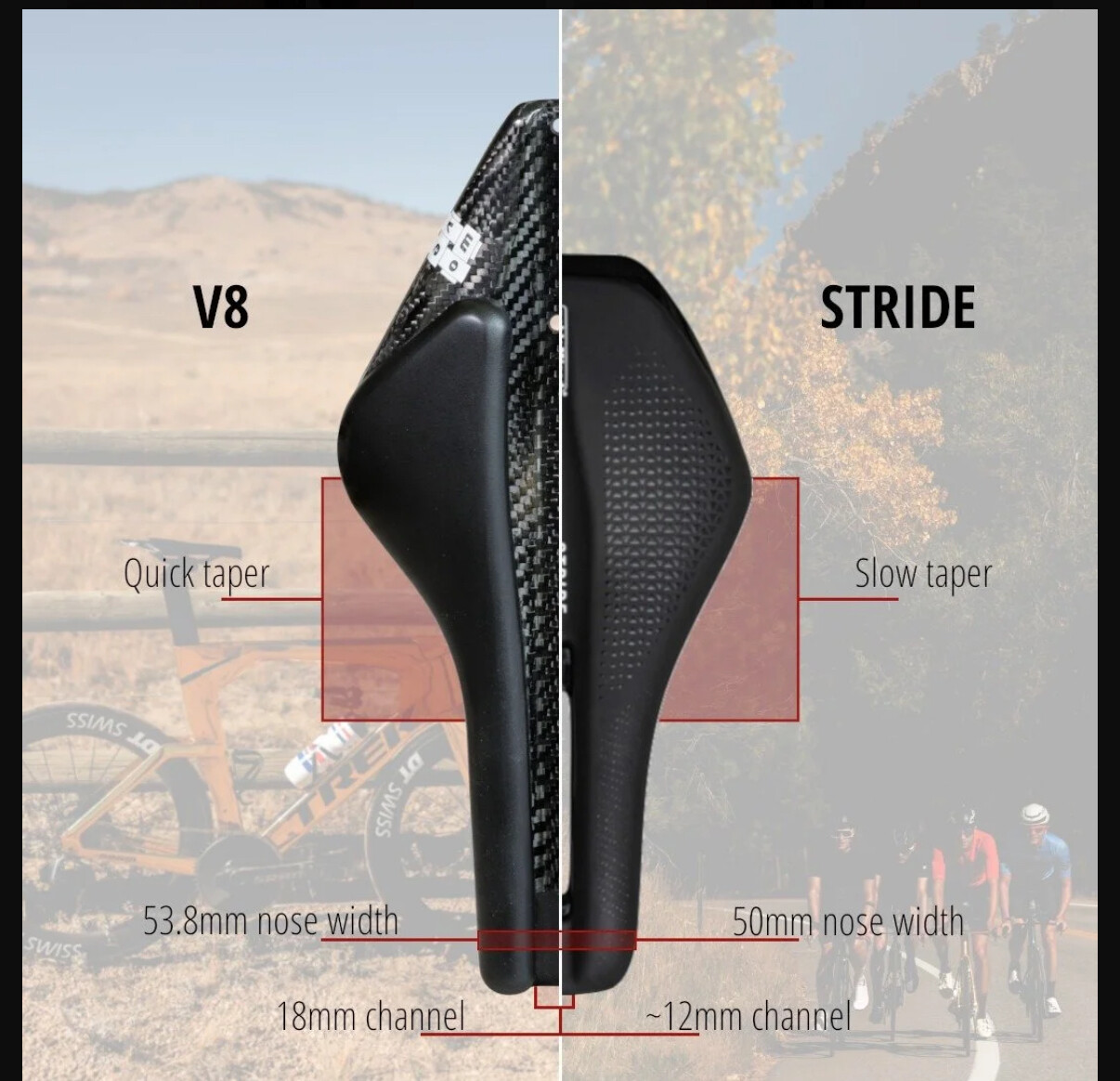

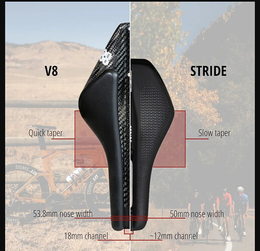

I just grabbed the Gebiomized Stride saddle per recommendation from Matt Bottrill’s YouTube channel. He states it works for 8/10 of the athletes he bike fits. I love it so far!
I second the recommendation for the Gebiomized Stride. I learned about it from reviews on Slowtwitch a couple of years ago. Very comfortable.

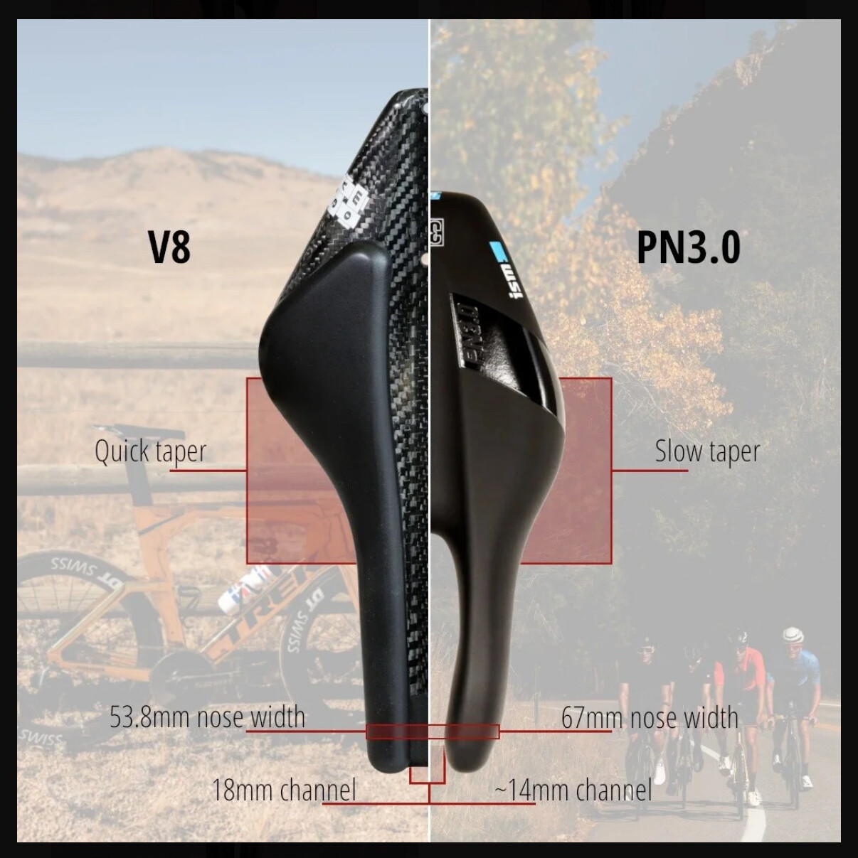

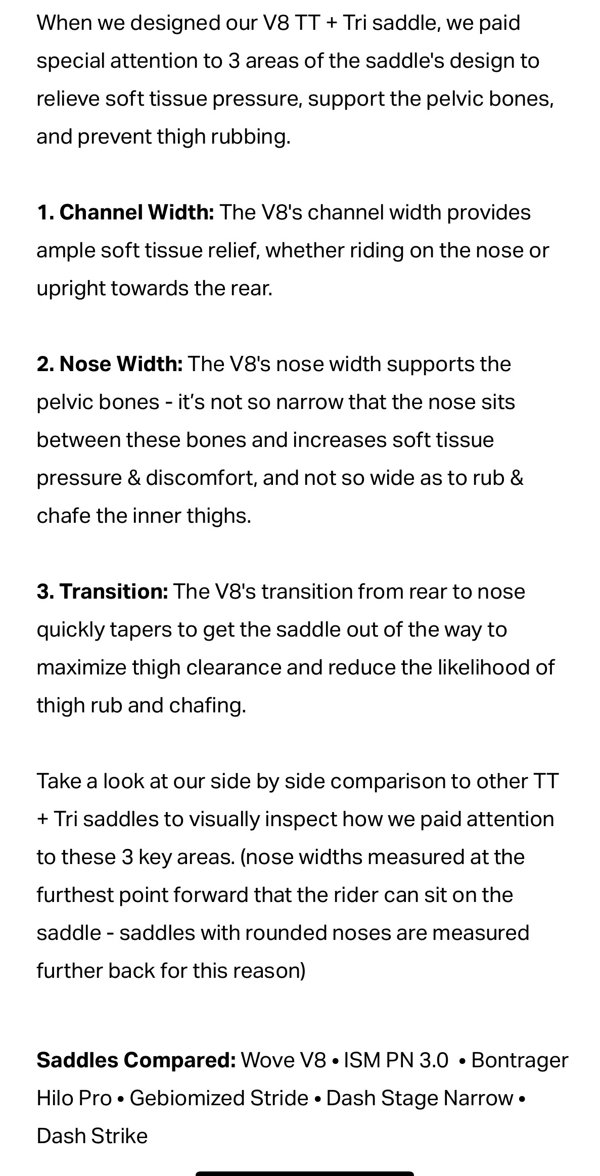

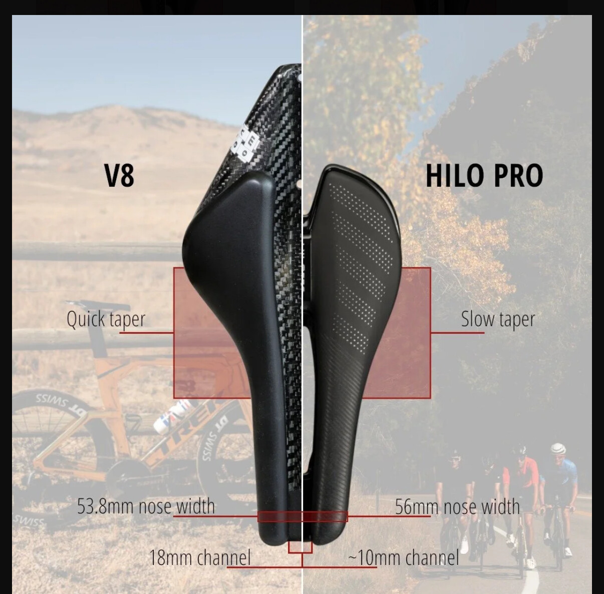

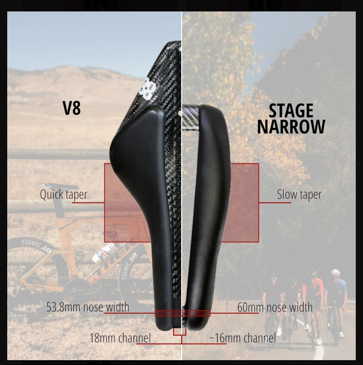

Some quick side by side comparisons
  • 30 day no-questions-asked return policy
  • Lifetime warranty on the carbon
  • One year warranty on the foam (lasts 15k miles), and only $100 to replace foam after that.
  • Our dealer network is rapidly expanding, so there is a better and better chance that there is a dealer nearby for you to try a saddle in person
