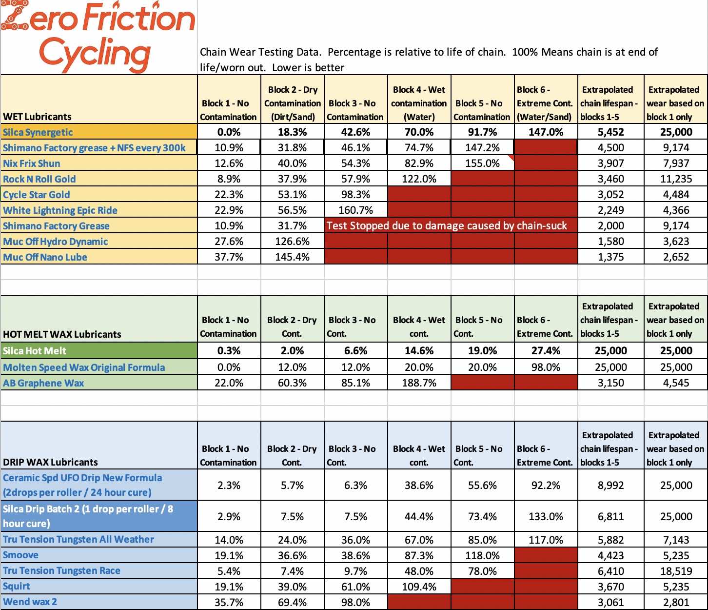

According to ZeroFrictionCycling for their race prepared chains:
****LATEST UPDATE ON FULLY OPTIMISED RACE CHAIN PREP OPTION – up till 20/11/20 this was done with mspeedwax and race powder (after controlled chain break in, many ultrasonic cleaning rounds, ultrasonic wax with fresh wax, controlled wax break in run – then the race powdering application would occur). As recent data release with UFO drip v2, it has shown Silca Hot Melt is around 1w faster than race powdered msw chain, as such FULL RACE optimised chains now undergo all the same steps but will be waxed with Silca Hot Melt and not race powdered after wax break in run). **
Source: https://zerofrictioncycling.com.au/product/12-speed-chain/

MSW race powder over SILCA wax in the lab ranges somewhere between slightly slower and no difference depending on how much the chain has been run in on the work stand.
We have seen slight efficiency gains by dusting a waxed chain with WS2 nano particles (the particles in SuperSecret are 10x smaller than MSW) and have provided this to a few pro triathletes and teams, but honestly, it’s at best less than 0.1w improvement that comes with a big inhalation risk requiring respirators and the like and is absolutely impossible to clean from any surface that it touches… absolutely not worth it in my opinion.

Lastly, we’ve posted this before, but here’s the ZFC rundown on the waxes, you can see that the WS2 in SILCA hot wax is not just faster, but ~4x lower wearing than the MoS2 and PTFE that MSW uses.
