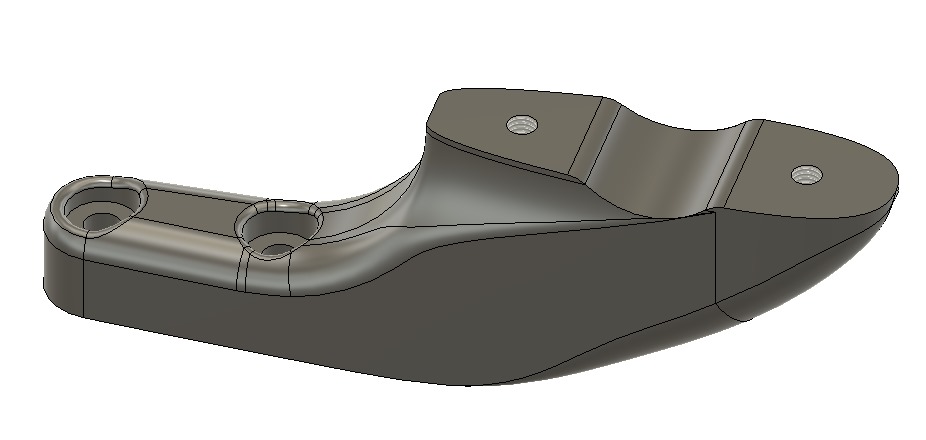

When I fit Rudy to his new Factor, we needed a custom spacer to achieve reach the Hanzo does not natively provide. We could achieve the stack, but the further you raise the monoriser on the Hanzo, you lose reach due to the riser following the hta.
(we didn’t have time to print one prior to Kona, but here’s the printed spacer that achieves these same additional reach as what he used in Kona, that we’re installing now).

The spacer costs over $700. It is mated to the bars. Yes, like the velobike solution I linked to in the OP, the spacer alone could be the solution. At this time, that spacer solution is not available without the bar. In the OP I wrote that I do think the market will respond and create more affordable options, and more spacers like the one Rudy is using are a great option - but the reality is that for him and others, that spacer was only available with the expensive bar.
