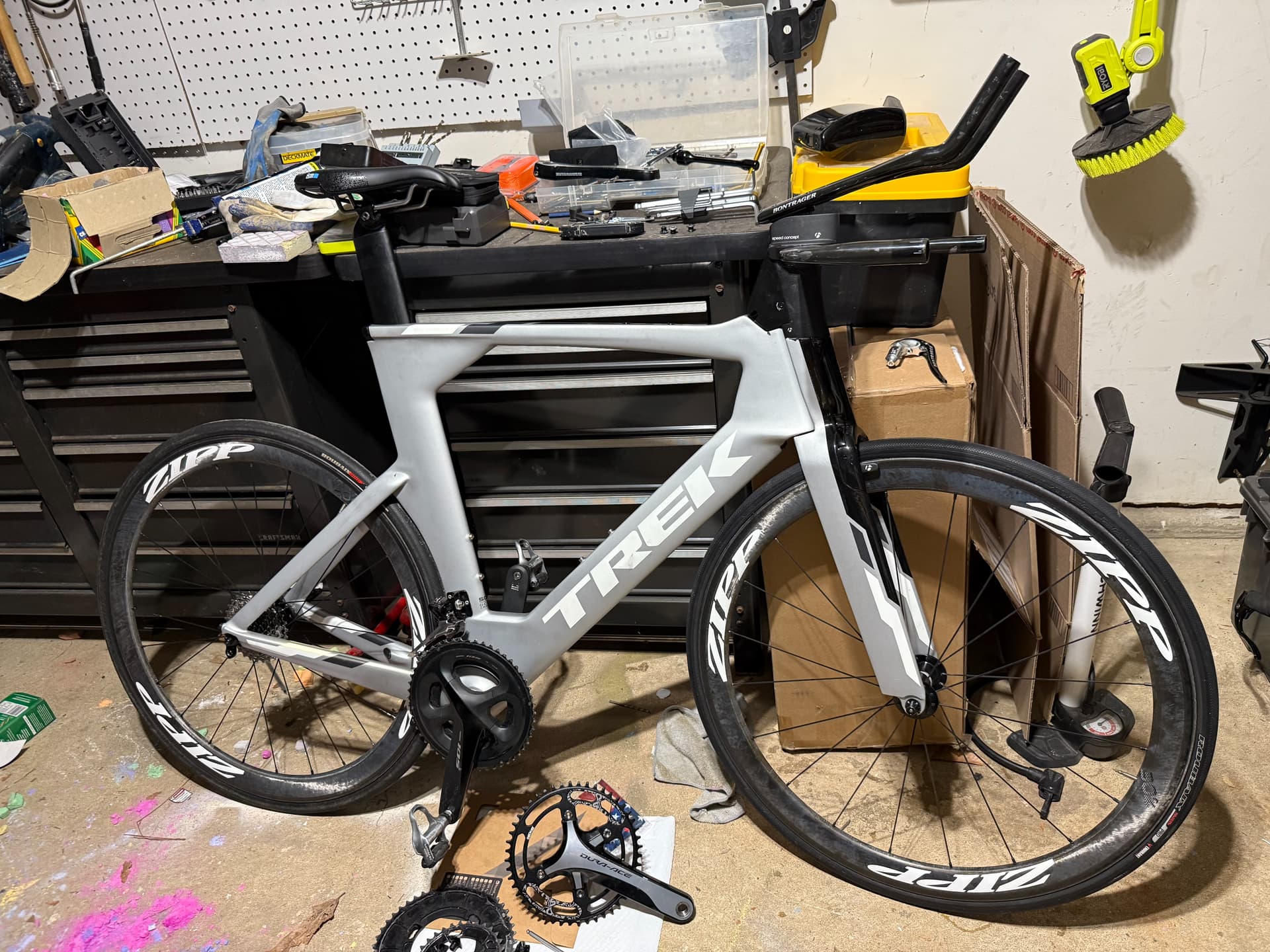

I will share some pictures etc once I start building, but I’m pretty much set with my budget Speed Concept build.
Picked up a 2016 XL frameset in Classifieds for $550, came with 105 11sp crankset and derailleurs, as well as Bontrager brakes.
Thanks to some kind teammates, I was given a Dura Ace 9000 crankset + AXS Rival RD with battery and charger that I will use, and a bunch of extras that I can sell off. I bought 4 wireless blips on JensonUSA with 20% off at $160 and a cheapo 1x NW 50t chainring for the crankset at $30. I also found a set of Zipp 302’s on Marketplace for $250 to replace the initially purchased Easton EC90 TT tubulars. (I was hoping to upgrade the freehub or just build with 10sp, but being given the AXS RD changed that plan.)
So with selling off the wheels, extras and 105 parts, I should be all in on this build at less than $800.

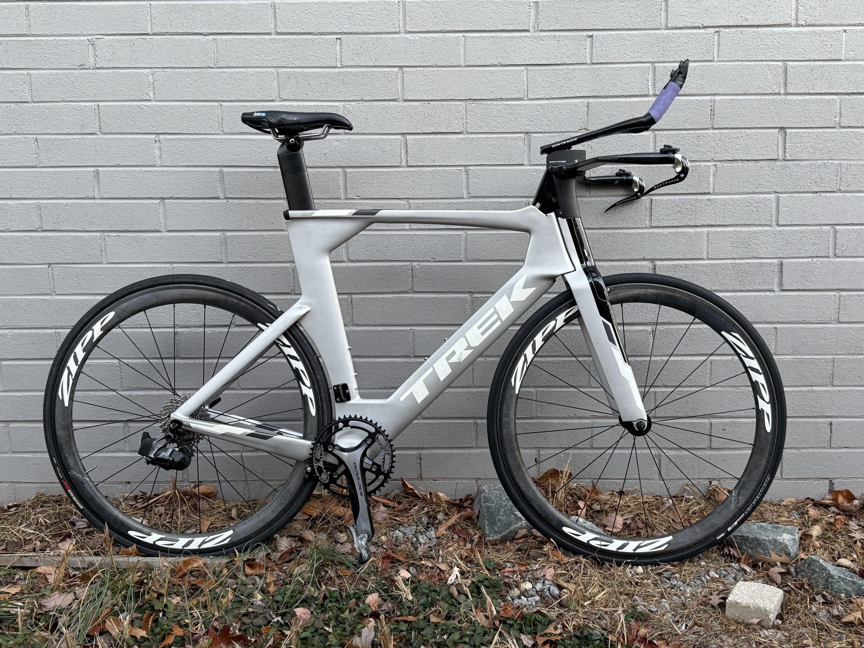

Still needs a chain and to pull cables for brakes and wrap base, but all else is at least functional. I’ll probably get an aero chainring once I’ve settled on size. Currently with a Rival AXS RD and blips on extensions with 3D printed holders and OEM holders on base bars.
What cassette have you got on the back?
I have a 10-33 and a 10-36.

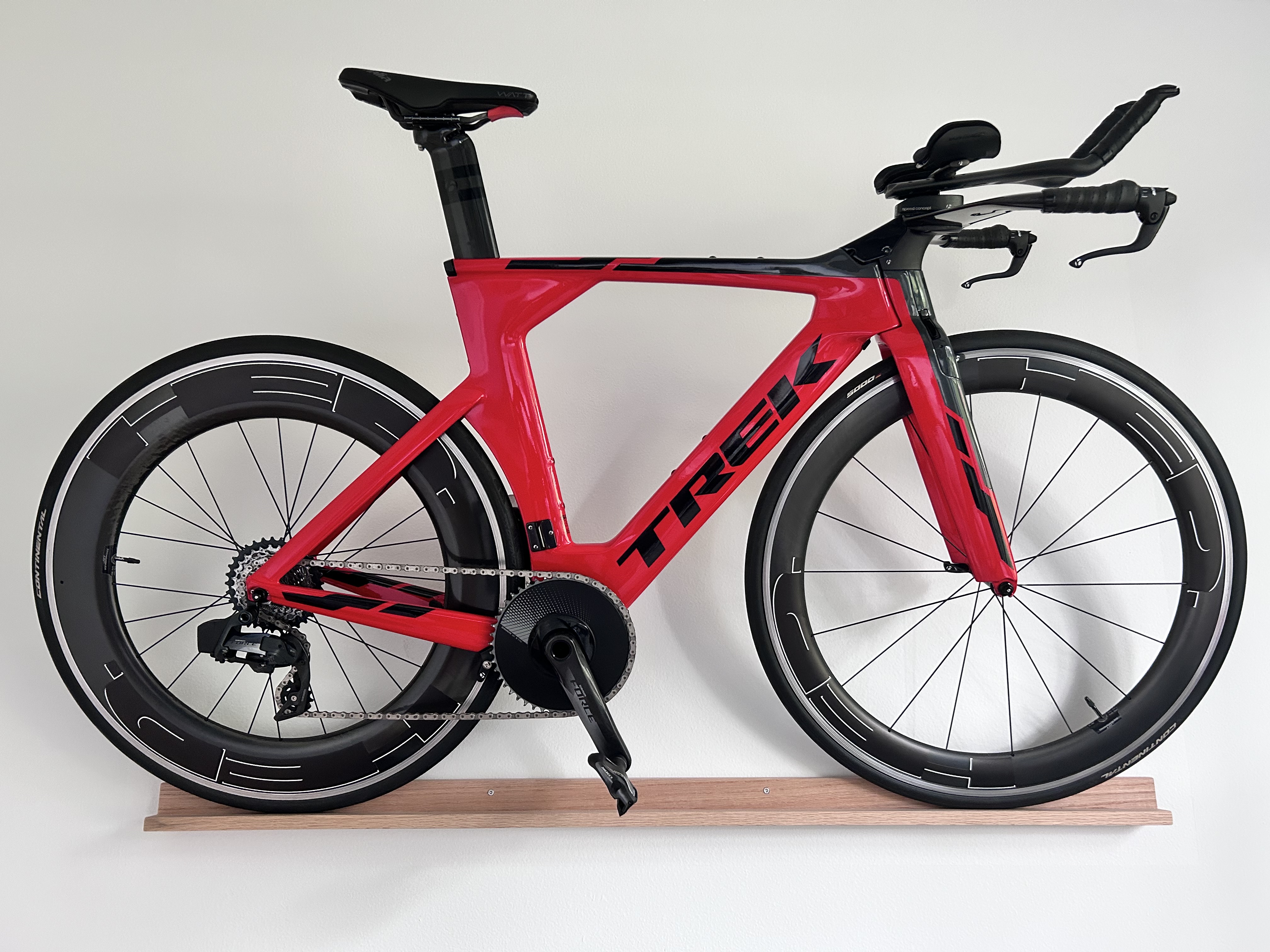

Here’s a bike I built up with a minimal AXS setup…
Sram Force RD, 10-28 Sram Force cassette, 1 set of wireless blips on the aero bars, Neat Components 45° Blip Holders, 48t Sram 1x aero chainring
