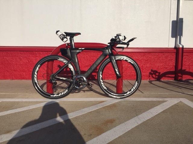

My Cervelo p5 paint never looks clean (even after being cleaned). What do you use to clean your bikes with matte paint?

Not sure why it inserted up side down, however, what measures can be taken once rubbed too hard or used harsh products. I don’t know exactly how this happened but the spot on the seat tube is most prominent. You can see a little on the head tube as well, and up close the matte is pretty streaky. I’ve been searching for a solution to even it out. I use the WD-40 foaming bike cleaner and I used to wipe with WD-40 afterwards as a protectant…guess that didn’t work.
If that’s not grease or oil suggesting that the areas are polished then I don’t know what will rescue / reverse it … :frowning:
Have you ever aggressively scrubbed / cleaned / polished in those areas ?
Maybe consider a partial wrap ?
If all else fails spill some energy drink over the front, blame the back on piss and tell people you don’t wash it … ?
