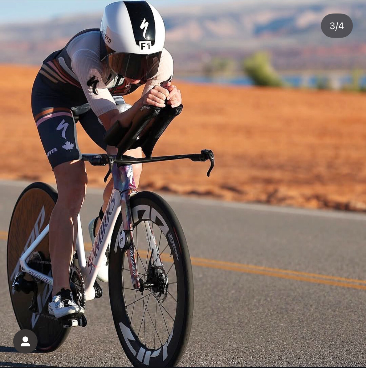

My guess is that because it’s part of the front end cockpit and “in your face” about it, vs say the brake covers that more or less “blend” into the bike, it’s much more “obvious”. Please note that for the most part I basically said, I accepted the mono bar is really no different than the brake cover, so ban them all (if we are going with the fairing ruling, or just throw out the book and go full in on “fairings”). But I also recognize/understand that there is sorta an common sense line here. Why the hell would we allow disc wheels if we are claiming fairing. So that line of thinking may not make sense, which is kinda why I went with the layman…look that “looks” like a complete fairing that we are trying to keep out of the sport. So in that “sportsmanship” viewpoint, this would be a bridge too far.

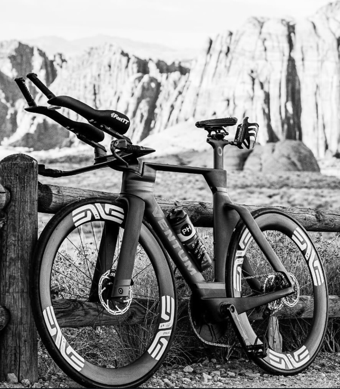

Essentially coat that tape in epoxy and you get carbon fiber. If Solveig’s bars had tape in the middle of them they likely wouldn’t have been dragging as she was biking. Not saying it’s a major structural weight bearing thing (without the epoxy at least) but the tape does hold things together at least.
Aside from that, I’ve seen aluminum parts snap, break, cages fly off, etc. It’s not as if these rules are creating ride-proof bikes that don’t get damage from potholes and railroad tracks.
The shaped shovels that are being mounted to the front of the bikes are indeed stronger though. To say they need to be separate is a little bizarre because once you go tall enough you essentially need a bridge to connect the system and add rigidity anyway. So it’s pretty lame to ban the shovel but allow the bridge, but ban the tape. They just need to rewrite the rules that allow that area between the arms to be filled.
They just need to rewrite the rules to limit the max dimension of the two bars to 50mm, to prohibit the area between the arms being filled except with a single bridge max dimension 50mm not more than 80mm from the bar ends.
So just let me make sure I have it all correct. In the past year sport governing bodies and individual federations have started to crack down on front cock pit “fairings” right? So I think if your doing that and then you show me a pic of that monobar, I don’t know how you don’t come up with…wait how/why is that legal and other things on a front cockpit are now illegal?
Again if it’s legal, cool. That I dont think makes it immune from common sense “that’s a fairing”, that now other similiar parts are being picked apart as now illegal.

If you’re allowing shaped individual arms with a hacky bridge in between, why not allow the full setup that can then have clean mounting for a computer, water, etc? Because it’s expensive for new commers? Weak sauce.
Because it saves some watts? So does a disc.

But isn’t part of the issue that who essentially is the provider of the aerobar determines if it’s legal or not. IE like the brake cover, because the company says it’s part of the integrity of the part, it’s legal (bullshit that the cover has to be a part of the brake for it to work, you know i, i know it, they know it…but that’s the technical runaway, etc). But if you build it up yourself into basically the exact same configuration that’s illegal.
IE if you “add” devices to then make it essentially a single unit, that is illegal. But if it comes by the manufactor because they say it’s part of the design, that’s legal? As the kids say these days- make that make sense.
Mind you I am not talking about a complete frakenstein type of setup, that can actually be an “safety” concern, like putting 300mm of stack or whatever on 2 tiny ass bolts. But if you essentially replicated the exact mono-bar but like welded a front “fairing” plate between the 2 aerobars or whatever, that’s illegal, but the monobar isn’t?

Also, there’s been lots of hating on LCB’s setup. But let’s not forget who the first was to run a monobar….

So if they are cracking down on the “fairing” setups, I just would think this one would have to fall in as well. But because it’s some “structural” component of it, allows it to pass the “not fairing” test…thumbs up emoji.
