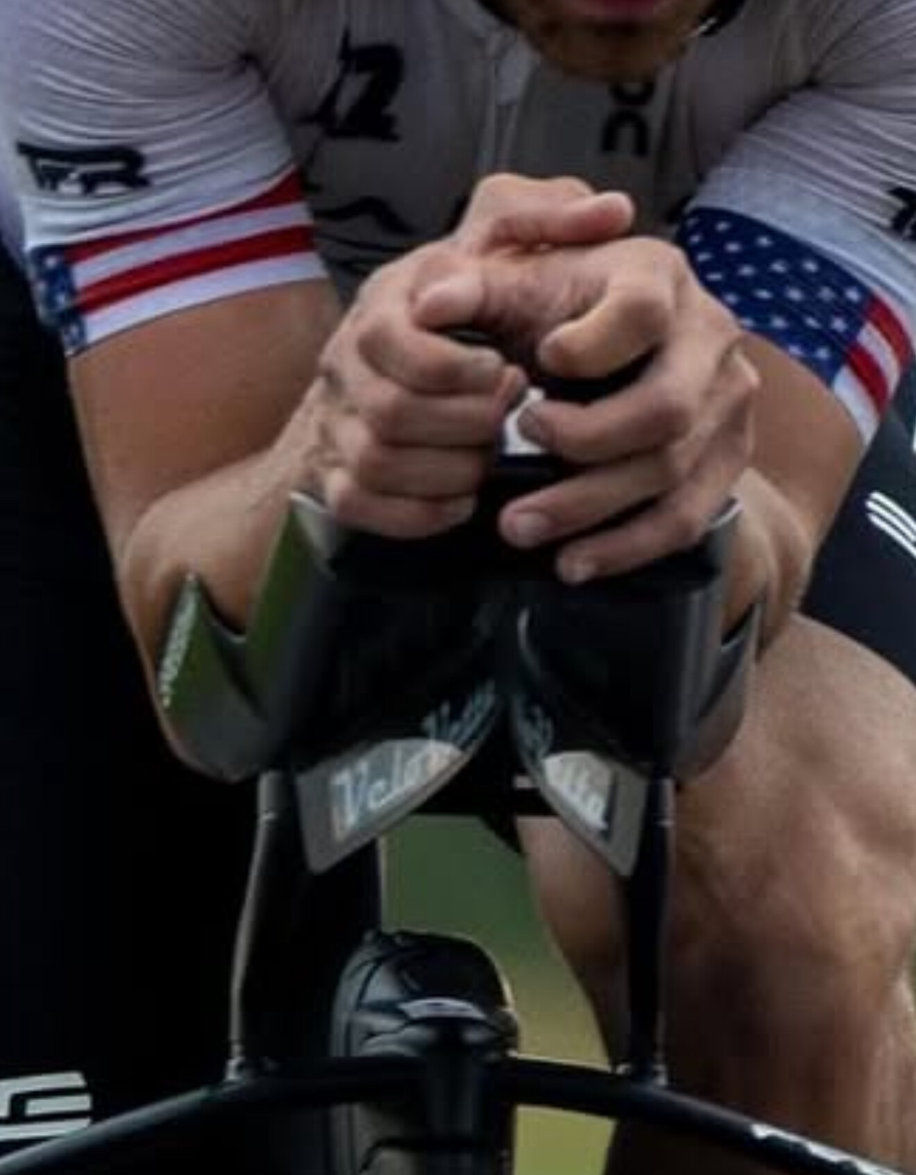

The current UCI rules are complicated and bigger and smaller businesses, for example the mentioned wattshop, do all to still design the extensions as fairings for the arms. For triathletes they often have fully faired versions. The UCI better had restricted the extensions to 22.2 mm circular cross section years ago before the journey to fairings began. But hey, this approach is here usually applauded as innovative.

That’s the issue with some of these cockpits. It’s clear that if you happened to add something after the fact to a “regular” bar that it would be considered a fairing. But somehow this one piece bar isn’t one, when it’s simply had additional carbon “blended into the structure with the intent to reduce resistance to air penetration.”

Objectively they have ceased to be aero extensions and have become the very definition of a fairing. There is no debate, it’s so patently obvious it boggles the mind.

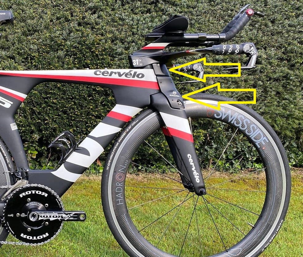

C’mon, let’s keep this real. The original Cervelo P5-six was introduced ~15 years ago. It has been raced and used with obvious fairings since the very beginning and no one in the tri rule-making world even blinked an eye.
See head tube & brake covers highlighted with the yellow arrows: these are 100% non-structural and fully removable aerodynamic fairings.
you forgot the front wheel is also a fairing … there is 0 structure in the carbon part.

If we want to change the rules to outlaw monobars, we can have that conversation, but I first want to ask why? What is the problem with monobars specifically? And “it’s a fairing” is not a valid reason. I could argue lots of things are fairings these days that people run all the time (eg; extensions like drag2zero, wattshop, speedbar, tririg, etc).
