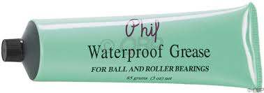

I just used Phil Wood grease on any bike part that calls for grease plus I put in on threads unless I am using Loctite. No problems so far . . . . Buy a tube. It will last for years. Plus, it looks pretty in your tool box.
https://encrypted-tbn3.gstatic.com/images?q=tbn:ANd9GcQCfefEQbXOzr5netYvC19LBtUyp0b9sLPbBqnW9sgXeP0GW5yI
