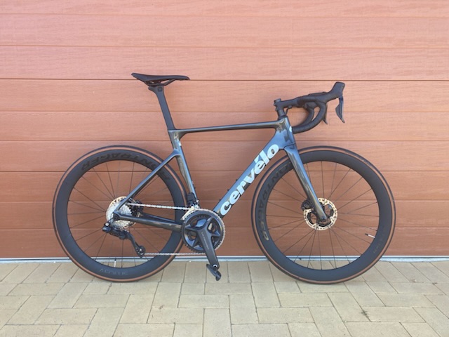

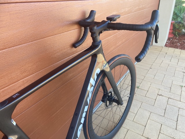

Cervelo Soloist.
Actually gives you the option to run the cables through the stem OR externally. Your choice.
Not sure if it qualifies as a “high-end” bike, but you can use whatever bar and stem you want on a Cannondale SystemSix.
Cervelo Soloist.
If I was buying a road bike today, that’s what I’d buy
Cervelo Soloist.
Same! So much so, that I sold my Parlee RZ7 and did :slight_smile: Even thought it was a “downgrade” in terms of MSRP, the Soloist is an amazing bike. Honestly I feel like it’s the bike I’d recommend for 95% of people (assuming it’s within the budget).

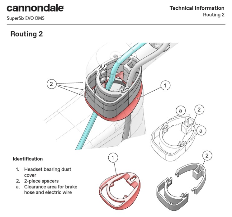

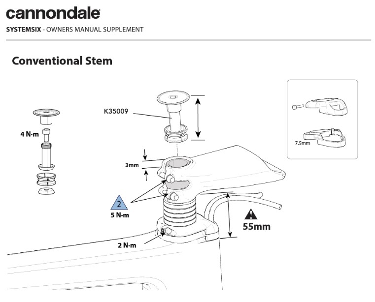

I can verify the following Cannondale frames let you run whatever stem and bar you like:
SystemSixSuperSix EVO3SuperSix EVO4SuperSix EVO CX & SESynapse
Some bike models sold with these frames already include bars with internal hoses, so you’d have to re-route the hoses to change the bar. Of course you’re free to take off these bars and put on your bar and stem of choice. In other words, the integrated option is optional and standard bars and stems also work.
Details can be found in each model’s Owner’s Manual Supplement here https://www.cannondale.com/.../owners-manuals/road
Here’s how the hoses fit into the new SuperSix EVO4’s frame via the Delta steerer tube:
The EVO3 and SystemSix are similar to each other, and both different from the EVO4:
Cervelo Soloist.
