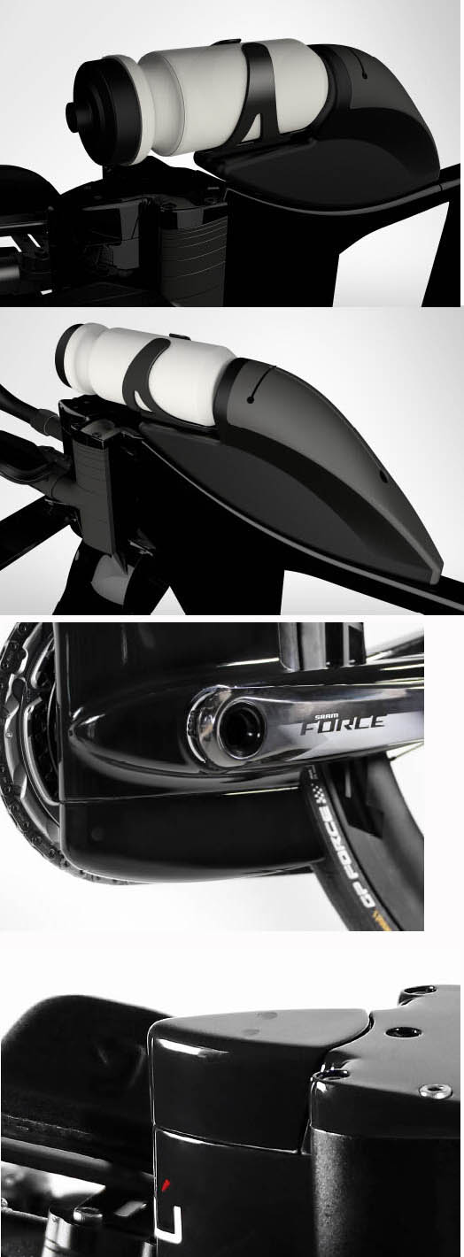

There is special tubeless storage unit at the Steerer Pivot Box that can hold a CO2 catridge, inflator head and a Dynaplug micro pill. The bike is designed with a tubeless set up in mind.
And there is a ‘BTA’ and storage specialy designed to sit in line with the top tube. With the extensive aerotesting we did in August with Gebiomized and Hycys we have seen this a great spot.
And having the bottle there and the weight not on the aerobar can improve the handling specialy for smaller female riders

TThe bike is designed with a tubeless set up in mind.
Then they might reconsider their pictures showing a GP Force.
https://www.ku-cycle.com/wp-content/uploads/2020/10/tech-specs-img-12.jpg
Specs do say GP5000 TL
Touché, :wink: but at the time of the photoshoot the proprietary wheels weren’t available yet. Or better said the XDR hubs for them, so we had to set up the bikes for that moment with different wheels sets.
Sometimes you have these small setback’s but when everybody else like photographers and all stuff is arranged that happens.
But the design was designed around the use of tubeless that’s why they dis that very easy access TSB unit at the Steere Pivot Box in case of a larger puncture. No need to take the bike upside down, just grap the Dynaplug micro pill, plug thhole and inflate with Co2 catridge. Very easy and fast
