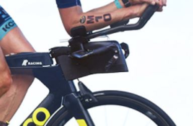

First thing I noticed which is cool is what appears to be Tririg’s new prototype rim brake on Andy Pott’s bike.

Do you know the gearing of Frodo (same as Sebi?) and his cranklenght?Are the wheels of Frodo and Sebi the same (both firecrest)?Is Timothy O’Donnell on tubs or tubeless?Guess Timothy O’Donnell is on AXS eTap as well (you mention AXS for Frodo, but not for Timothy O’Donnell) ?Isn’t it strange/striking that the top 3 (and the fastest rider, Wurff) does not use some kind of OSPW system? Can we conclude that OSPW is one of the last investments one should make?The same question for a special treated chain…Are Wurffs aerobars 3D printed titanium, or just his extensions (I think the latter)?Is Wurff on tubed tires (inner) or on tubs?Ben Hoffman is on a P3X, so no top contenders on a P5X. Can we conclude the P5X is obsolete?Skipper is on custom (Revolver I guess) cups?Why are the bars of Skipper not flat? No way to independently tilt the extensions? Doesn’t look aero (still rides fast).Currie: Tubeless or latex inner tube (think the first)?Currie: Special OSPW system with aero cage. Only one using this one. SLF?With Koutny you mention that he has no Visor, but in the photo he is using one (transparent)Koutny is on Bont (Zero+) shoes and uses Ceramic Speed OSPW systemAernouts, tubs or tubeless (why not on GP 5000?)?Aernouts, Ceramic Speed OSPW system and Tririg front brakeTim Reed: why no draft box?Tim Reed: small front ring compared to others?Tim Reed: Doesn’t seem to be a Oakley Sutro sunglass (Sutro has thinner legs)Weiss: 1) goddamn that bike is fugly, 2) he is wearing Oakley Sutro glasses and not the Aerohead visor (why would you do that, fear of overheating??)Potts: Wouldn’t he be faster with a better/other helmet (judging only from this pic). Also: tririg brakeDaniel Baekkegaard: do you think those wheels are slow(ish)? And do you agree that different coloured tires should lead to a DNF or at least a penalty? (pink-ish).Daniel Baekkegaard: why no bento?
