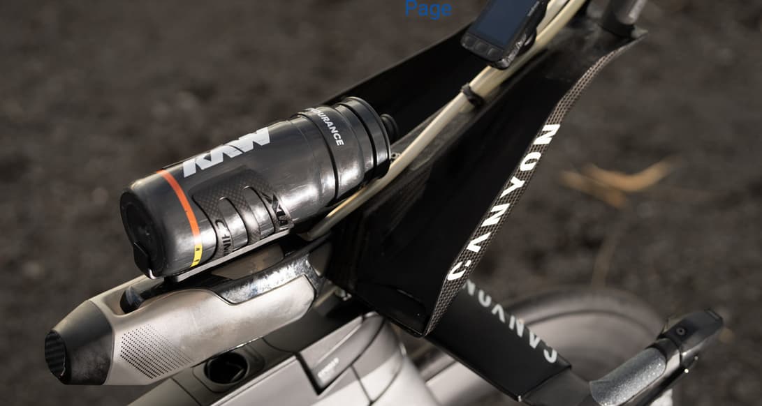

  2. Same lower BTA bottle set up as the ‘nfamous illegal one from Frejus, I think, but neatly mounted an inch further forward. It’s a cockpit not a cock pit btw :wink:

About 2: No. Looks like she is using the Trek RSL Aero Bottle. Hayden used the Canyon Fuel Aero.

Also has she bodged a drink straw into it? Looks like rep straws, one to the bladder and another to a bottle?
he bodged
Yep: that aero bottle will be gel-full but fluid enough to suck up.
That is correct.

Interesting, so what are her plans once it’s empty I wonder. Being a fidlock set up its not as if she can replace it with a bottle from aid station. Maybe special needs?
It’s not Fidlock as it is the Trek Bottle not Canyon. The Trek Aero Cage can fit a normal round Bottle, might be why she chose that.
Ahhh good call!
You identified it as the Trek RSL Aero Water Bottle. It has a height of 240mm (with nozzle - is it there? - Edit: see image below I’ve cropped from main ST article) and a volume of 591ml (duckduckgo tells me). If using e.g. PF 90 Gels (partner is RAW though) she can get enough slightly diluted gel in there for close to 450g of carbs (100g per hour, assumed). @gunna “once it’s empty”: We can see the tube inside the bottle so I reckon it isn’t going anywhere.
Three more cages for water filled bottles, replaced at aid stations.
If she isnt planning on dumping it why wouldnt she have used the Canyon bottle then I wonder? More aero and holds more fluid at 650ml
We don’t know, another reason could also be that the Canyon Bottle is massive not only in length but also depth (or width however you define it) so it might not fit between thr BTA Holder and Top Tube.
