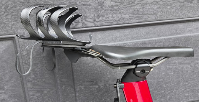

FWIW, I have had this setup for an ISM saddle since May, with double bottles riding shitty Wisconsin roads (all potholes and expansion cracks) and haven’t had an issue. I don’t see any stress fatigue. I also created an extender to bring my bottle over the saddle more so more of the weight sits over the saddle mount so less lever action.

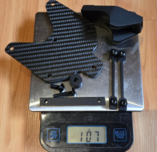

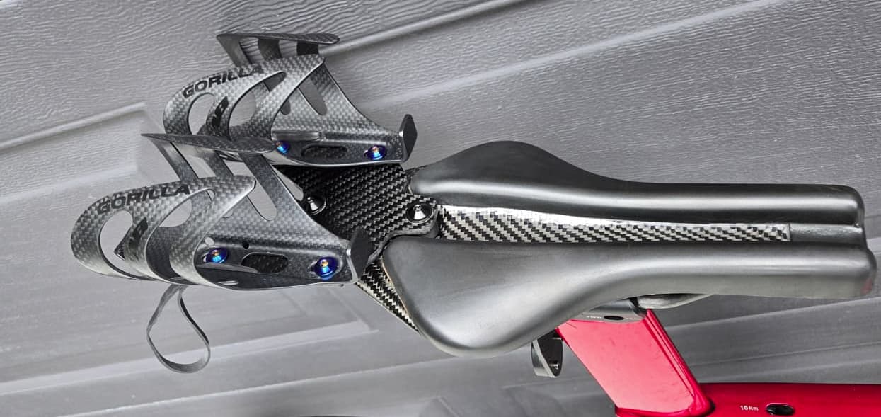

I am one of those that rigged my own setup on the Wove saddle when I saw Jim’s results for the side-by-side 2 bottle BTS setup….
… in which I was able to integrate a transition hook under the saddle as well: solves the issue of trying to pass the bike under the transition rack (with the extra height of the BTS setup).
Lighter than the EZgains setup, 107g to be exact. So Saddle + BTS hardware (before adding cages) is still lighter than most stand alone saddles.
It is lower profile as well, easier to swing my leg above it during mounting. Although maybe less aero than when the bottles sits higher?
(more details in the Wove Saddles post Wove saddles - #210 by spocket )
While there are 3d printed parts (spacer and transition hook), none of them are structural and the setup is super sturdy and rigid: I would trust my setup over any of the EZ gains configuration going from the brackets under the saddle.

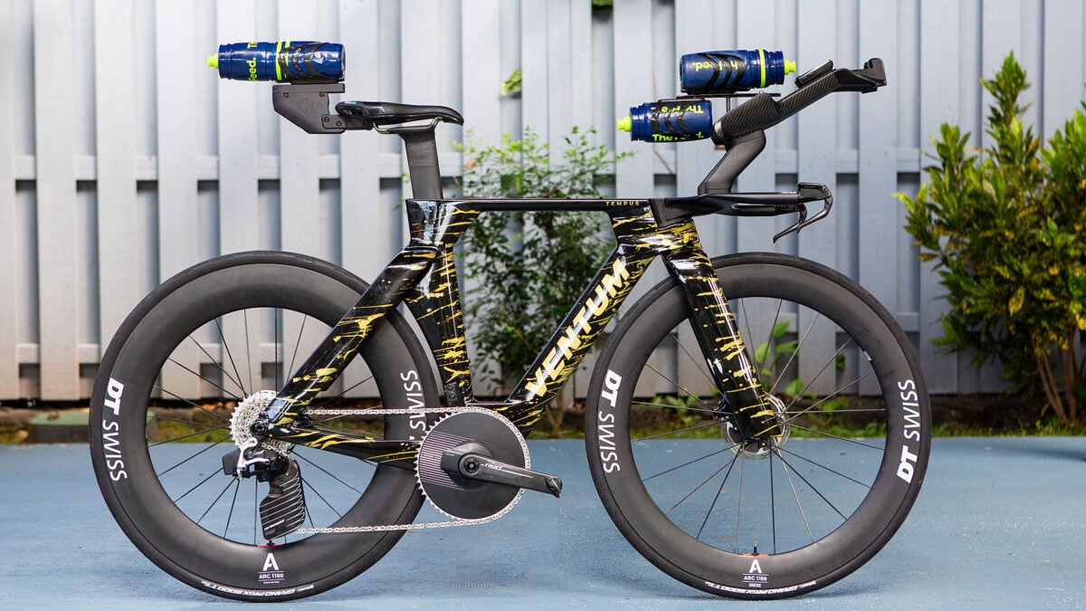

Chelsea Sodaro
Is it just me or does that top tube look really short?
Maybe the frame is size small?
“Chelsea Sodaro will be riding an eye-catching Ventum Tempus in size small with fully-custom paint, special details, and two entirely custom carbon modifications.”

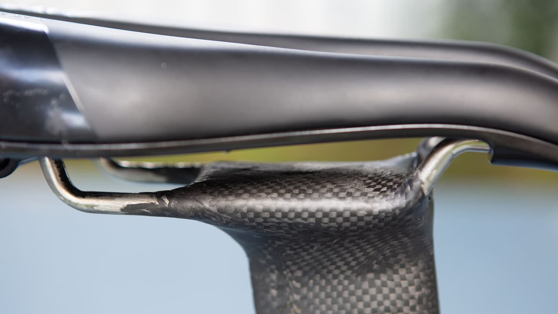

Unrelated, but the seat to seat post mounting is very unique.
Wow…. You’d wanna get that for/after measurement bang on before you just smash some carbon all around those saddle rails !
[Slaps top of saddle] “Well, that ain’t going nowhere!”
lmao that bottom bottle BTA looks like a bottle for 5 year olds. There’s like 5 sips of water in there.
Concentrated carb mix maybe?
Lol i legit use a bottle for a kid as my bottom BTA - use just for gels - get in 240g of carbs in it
