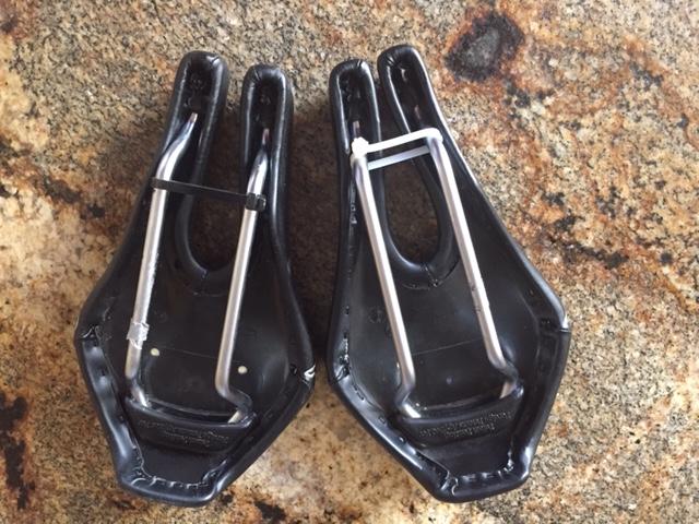

To the OP, I don’t have photos but what we did was hold the padded prongs closer together and put a couple of zip ties around the rails (underneath the prongs) to hold it there. This a) voids the warranty (if you care) and b) doesn’t last forever as eventually the zip ties broke. I next bought a hose clamp, which was pretty tough to get into the small space and was also unsightly. That’s about when I moved on to Koobie which is already narrower.
These are two “Road” model saddles with different degrees of squeeze. Never had a zip tie this size break but if concerned it would be easy to use an even heavier one.

I have ridden a few ISM saddles and needed to use zip ties. But once I found the PN3.0, there was no need for zip ties.
I started with a ziptie on mine, but replaced the ziptie with a metal hose clamp.

BTW…I‘m in the hose clamp camp.
Thanks for the replies. I’ll stick with my « Road » for now and use stainless steel tie wraps for a solid hold. PN 3.0 is on the wanted list but it can wait.

The seat clamp does limit how narrow you can make it. And even at it’s most narrow, the taper was still too wide for me. Stupid thing always gave me saddle sores. So after recognizing the problem and how to solve it (and after spending >$500 on used ebay saddles), I purchased a super cheap Chinese saddle for $15 and I LOVE it. I’ll post a link if I can find it again.

I wasn’t able to get the saddle narrow enough with zip ties because 1: the ties would keep snapping or (I’ve seen some folks use hose clamps) 2: the seatpost clamp wouldn’t allow the rails to move any further. I prefer the long narrow nose the of Fizik Arione, so I shaved the plastic base down, making it narrow enough that I could sit further back on the saddle, giving a greater surface area thus reducing the pressure points. The geBiomized pressure mapping confirmed this. I went from small red hot spots to larger green contact points.
