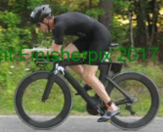

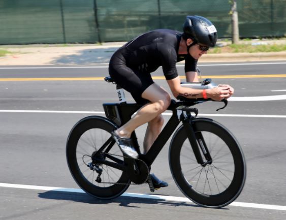

Even though I had fit issues at Raleigh, I found the saddle comfortable. photos of that sh!tty bike fit in action for a 2:17 bike at 3.32w/kg, not even 70% of road bike FTP.

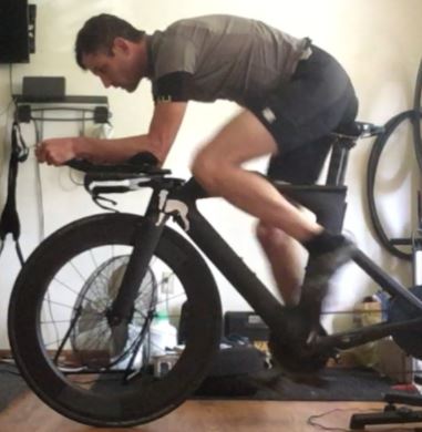

update: So, in the past when using the ISM Road and Attack, I had to angle saddle up quite a bit. I’ve always angled my saddles up a tad to hold me in place and it works great. But, on the tri bike, I have the saddle quite a bit more than the road bike. With the PN3.0, I had not going to such an extreme angle as I had done with the Attack in the past. I finally realized that this is what was making my fit so difficult with the PN3.0. I adjusted the angle last week, raced over the weekend, and it seems things are better. Now, while riding the Attack in the winter/spring, I was able to hold 285w for longer 70.3 efforts, but I’ve been stuck at 235ish watts on the PN3.0 in the aerobars, but that number pops back up to 285+ when on the pursuit bars and when on a road bike. My power numbers were still a bit low in last weekend’s race, so I’ll continue to tweak the fit, but as of right now, the PN3.0 alleviates the issues I was having with the Attack in terms of saddle/seam interference, and the angle I’m putting the PN3.0 at is the same I was having to put the Attack at. I guess I’d chalk that up to a success with this saddle and I’ll be sticking with it. My fit is much improved since tilting the saddle up.
have you play with your position over the years? with your current fit…i can see why you want to tilt you saddle up to keep you stable… but there are gain possible if you change the position and dont rely on a tilt to stablize yourself…
definitely played with the fit over the years. This crunched up position was due to sliding forward on the saddle. With the further tilted saddle, I was able to move the saddle further back and raise the saddle height some, but as I said, there’s still a discrepancy between road and TT power that I want to further reduce. video of fit with saddle tilt, though there have been further tweaks including raising the saddle height more: video
seems like your holding the bar very differently in the video vs in races.
but in a case like yours…the sliding forward is mostly due to not been stable at the front. but perhaps you dont feel comfortable rotating your hips more?
i would say in most case with the ISM fit…i allowed me to rotate the athlete over more around the BB so opening the hips angle and getting in more aero position. this result in most case in a tilt down saddle. if your weight rest solid on your elbow…there wont be any sliding forward…
there should still be a gap between TT power and road bike but maybe 5%…
much appreciated. In the photo, yes the hips are not rolled forward. But in the video, I’m not sure the hips can be any more rolled forward. For me, arm angle alone won’t hold me in place with a flat or downward tilted saddle and that means I have to use my traps, neck and shoulders to hold myself in place in a vain attempt, as seen in the race photo where I’m scooted forward. I’m not sold on the saddle titled down strategy, though I am seeing world tour road guys going this route and they look good while riding. I have played with that in the past and it led to neck and upper body strain over time even with arm positions that were at an angle that should, in theory, hold me in place better. I personally really do not like depending on my arms to hold me in place on the tri or road bike. I’ll keep playing with my current position and can post photos in the future of an updated fit.

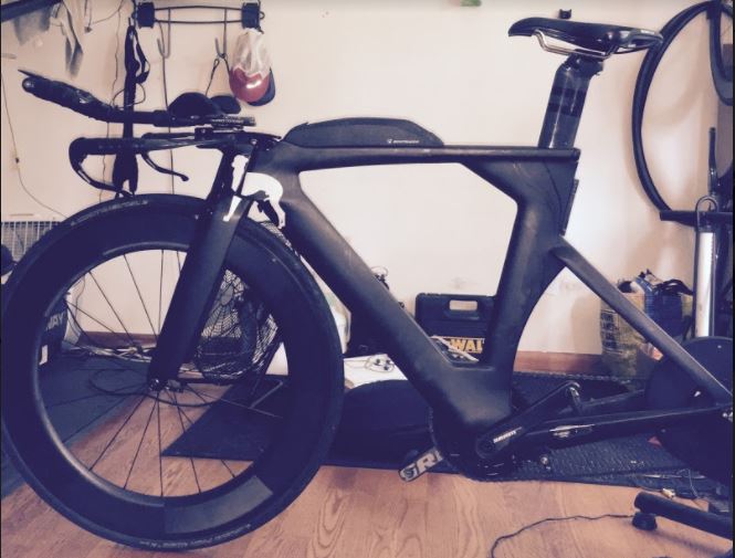

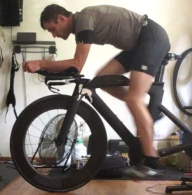

photo of current fit showing saddle angle - bike top tube level.
Video: Kickr set at 300w. https://www.youtube.com/watch?v=VZS9X93bg14

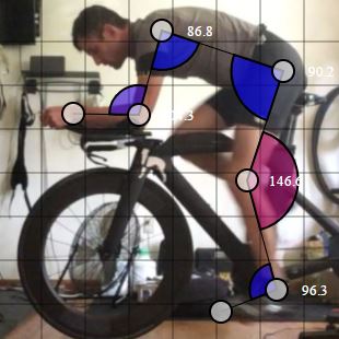

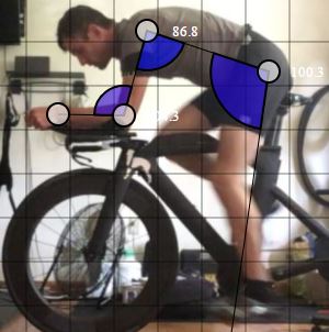

Photos from above video: pushing the limit of my saddle height and won’t be surprised if I lower it a tad in the coming week. Not sure there’s much more forward hip rotation available and this is the lowest the front end of the SC will go shy of mounting the monobar directly to the base bar, warranty be damned. As is in the video above and photos below from that video, my arms are very relaxed and I can easily stay in this position on the saddle even over rough roads.
Knee angle:
hip angle:
i m not saying it s wrong… and obviously…your the one that as put the time in the saddle to test it.
the 3rd picture look good…position is solid. was this taken while pushing race pace watts or soft pedaling on the trainer?
if i had you on a fitbike…meaning no limitation of the SC…i would experiement by increase reach and lower the stack of the front end… you have long arms and i can see how your pushing the limit of that bike size position wise. But i think your body would be ok with a shoulder angle above 90 degres. in most case anyway…it make you slippery and save watts.
Definitely appreciate the input. Was at 300w on the Kickr. I’ve had the monobar directly on the base bar before and while that’s an option for more drop, see option a) below. I can also scoot the pads forward, though that often strains my lats - I’ve tried but a Seb-like arm angle can be an issue for my lats.
I need the feedback, so thanks!
In my last post, pic 1 is just of bike, then video link and then pics 2, 4 and 5 are all the same photo just with angles added in 4 and 5. Pic 3 is 1sec later in the same video and shows closed hip angle - I’m on 172.5 cranks and I’m thinking of doing 162.5 to a) raise the saddle to get 1cm more drop which will help me because my arms are so long and b) open the hip angle more at the top of my pedal stroke - I race at 92-95 avg rpm’s and the shorter cranks could aid that as well
ordering the 162.5 cranks, so can raise the saddle 0.8cm - think it’s .2cm too high right now; my angles are a tad off too: greater trochanter is a tad further forward and that knee angle is actually 150-151, and hip angle closer to 101; so lowering a tad to get the knee angle closer to 146-147 will be good (based on my history of knee angle vs. power output and tendon strain) and the 162.5 will allow for more drop. I think that should be a good step forward for fit and for power production.

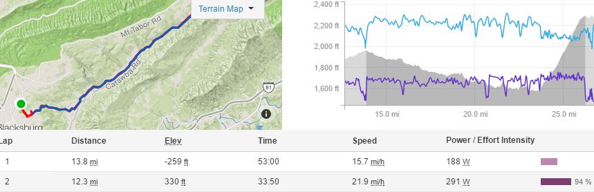

So, this seat angle is what works for me. My TT power is finally perfectly matched to the power I produce on my road bike at the same perceived effort. I lowered the saddle height by 1mm to ease some glut strain and it was good and bad: relieved glut strain, but the ever so slightly higher saddle height and associated greater saddle to pad drop provided a more locked in place feel.
I’m in the process of getting some 162.5 crank arms (purchasing through trisports.com; quarq dzero carbon w/out pm spider or any spider for that matter; mounting absolute black direct mount ring; $400) and this will allow me to raise the saddle 1cm and thus have the drop I need for a better fit and a more open hip angle.
Prior to tilting the saddle up to the degree seen in the above post, there was a ~45w difference between my TT bike and road bike/out of the aerobars on TT bike. Now, that 45w discrepancy is gone and I can hold higher power at a lower PE in the aerobars than when up and out of the aerobars, so this has me excited. At Raleigh 70.3, I held 239w (3.37w/kg) for a 2:17 bike split, but I was and I am confident I could have held 4w/kg on the road bike (based on my training numbers) and on my TT bike back when I had the ISM Attack saddle on angled up at the same angle seen in the above photo of the PN3.0 saddle. But, the ISM Attack caused major seam irritation issues. My recent training and today’s little ride with very punchy hills and rough road conditions confirmed that 45w discrepancy was a fit/saddle tilt issue and the discrepancy no longer exists, which is super awesome. 70.3 effort down the hill with some ftp work on that last cat2 climb to my back door:
