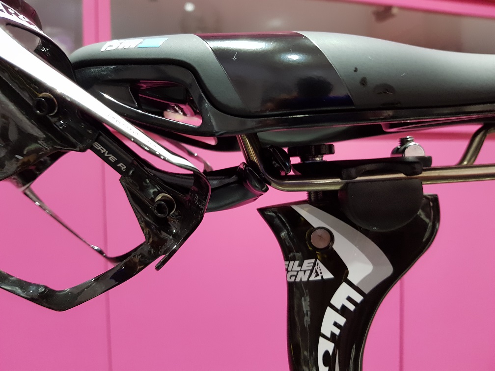

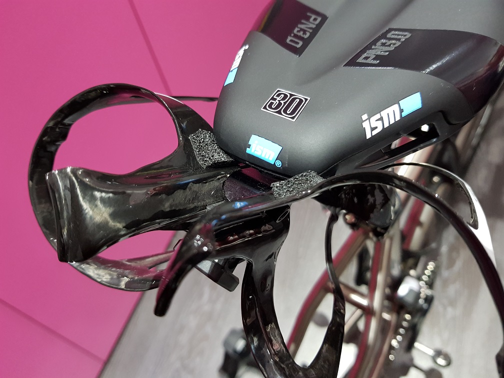

I just bought the PN 3.0 and it is a great saddle. Same problem with a few of the rear mount units.
I managed to get it to fit my old Specialized Reserve Rack II to the PN 3.0.
The bottle cage will sit very close to the saddle thus I added some sponge tape to cushion between them.
