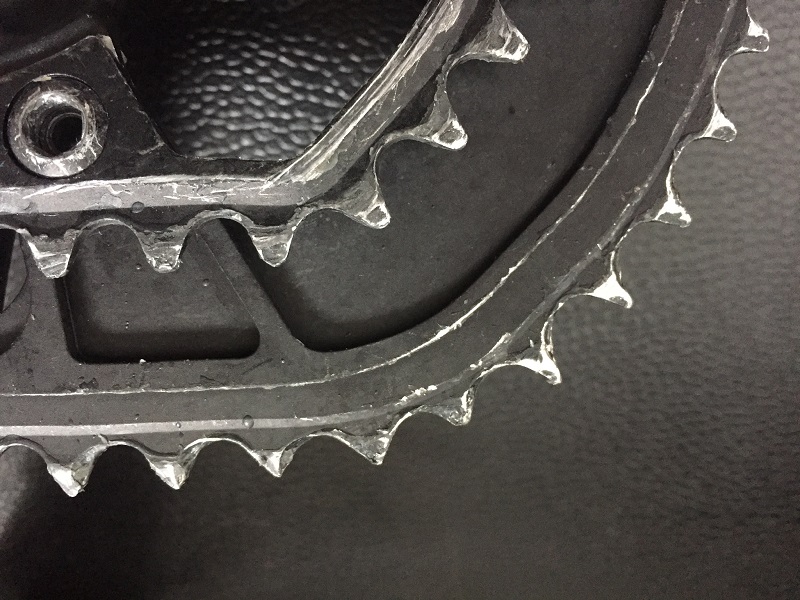

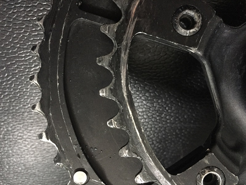

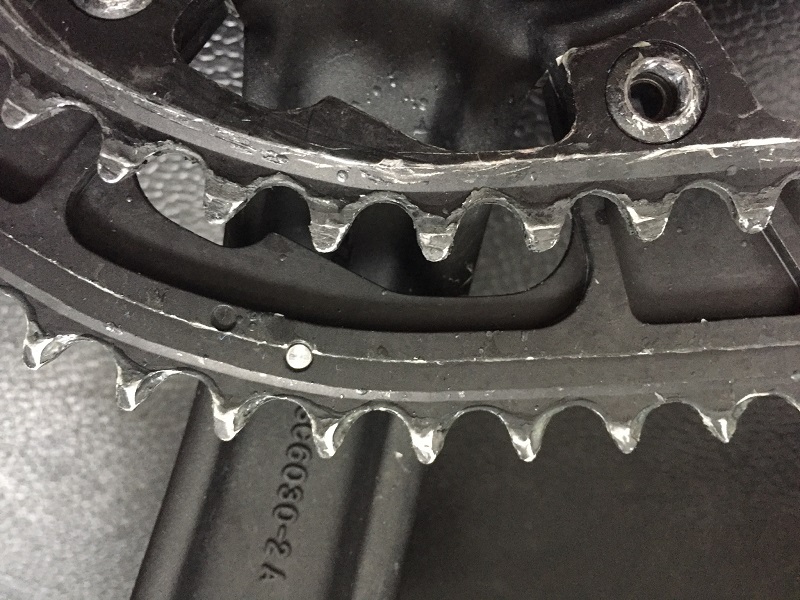

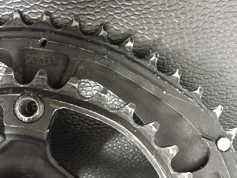

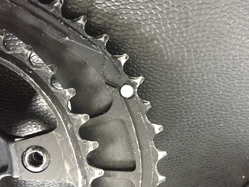

Is this chainring worn out and the reason for my chain skipping?
I’ve used them since february and 90% indoor. I don’t know if it’s skipping front or back.
Chain and cassette is new. Chain skipping on both small and big ring.
I had a similar issue. I my case it was my big chain ring. The teeth had worn and became a bit hooked. It would hang on to the chain then release. I had just switched to a new chain when it started. Worn chain and chainrings were ok. New chain and worn chainrings were not. Changed those out and I was fine.
I think my chainrings had about 35k on them.
Big, yes it’s trash.
Little, not so bad.
Wouldn’t think he would wear out a chainring in 9 months.
The rings have Done a total of 4700km indoor and 600km outdoor. I’m so surprised that they could be finished already
My opinion is based strictly on the wear I see on the teeth. I didn’t even consider how many Km on them.
I do agree that is a low amount of riding to produce that much wear.
Sadly a worn chain will wear out the chainrings (and cassette) more quickly, so it’s worth replacing the chain before it gets too bad - there’s a bunch of chain checking tools you can get pretty cheaply which help. Cleaning your chain regularly will help prolong the life, so distance ridden can be hugely variable depending on if you ride in the wet or not, and how often you clean your chain (and what lube you use).
Sounds like your old worn chain had worn your chainrings so they matched each other if that makes sense, so now they won’t match a new chain.
Biggest ring looks worse, but if it slips on the smaller ring you’ll prob need to replace that too. Maybe worth setting up on a wind trainer (wheel in if you have one) and getting someone to see if the chain is slipping on the cassette too. It might be that you need cassette and chain rings if your chain was that worn…
