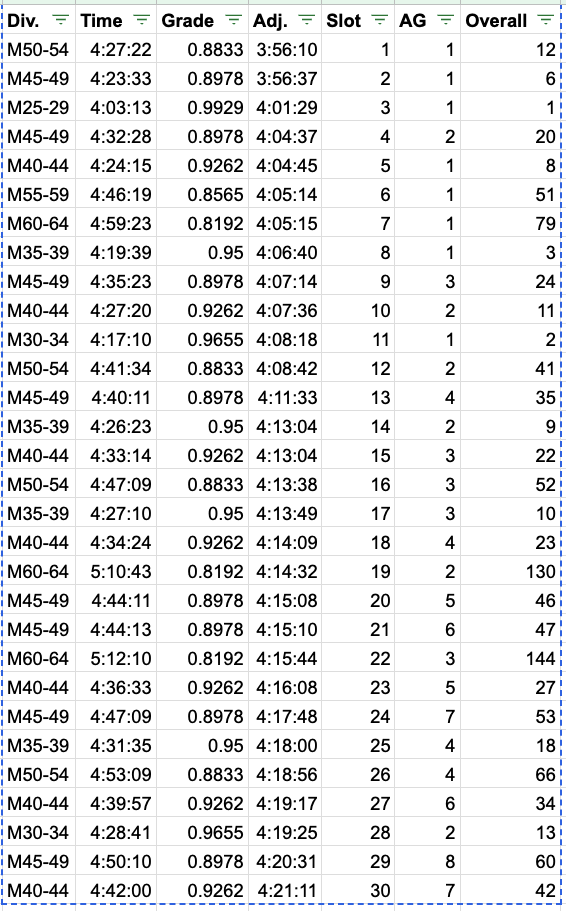

Anne is 42, she finishes IRONMAN Kalmar in 9:19:51, giving her an age-graded finish time of 8:07:26, applying the Kona Standard of 0.8707 (9:19:51 x 0.8707 = 8:07:26). John is 43 and finishes IRONMAN Kalmar in 8:50:31, giving him an age-graded time of 8:33:42, applying the Kona Standard of 0.9683 (8:50:31 x 0.9683 = 8:33:42).
Anne would rank above John in the age-graded rankings due to her age-graded time of 8:07:26 being faster than John’s age-graded finish time of 8:33:42.

| Finish Time | IRONMAN 70.3 Standard |
Age-Graded Finish Time |
| Laura F35-39 | 7:29:01 | 0.9658 | 7:13:40 |
| Janine F50-54 | 8:00:28 | 0.9016 | 7:13:11 |
