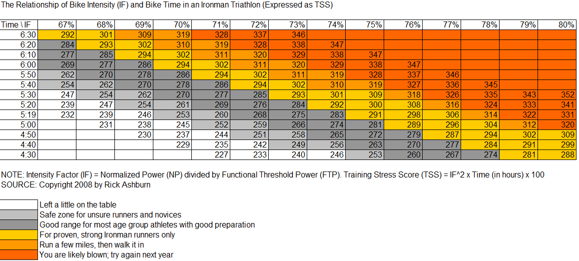

Speaking with past winners of the local Extreme Triathlon (Israman, ~3000m of altitude on the bike and a net 700m downhill in the first quarter of the marathon), there’s no way around exceeding the TSS “guideline” for that kind of race. On that kind of course, sometimes the extra time lost on the bike can’t be recouped by running faster.
Once you have chosen your target TSS (example : 280 TSS), then you still need to find the more realistic association IF / Time
Is it 66% IF over 6h30 ?
Or 69% IF over 6h ?
Or 59% IF over 8h ?
Simulation is nice, but testing in similar conditions is better, if you can.
You can test you on just 1 or 2 hours, on a relatively similar course (% uphill and downhill, altitude, wind, …) to see what speed (so what realistic time) you can expect at some given % of IF. This will help you choose the right targets % IF and time.
