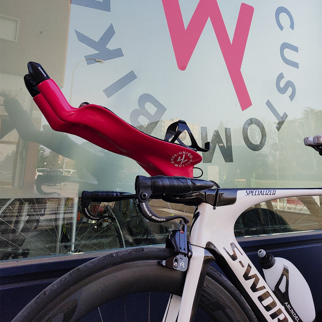

Hello, we manufacture 100% custom aerobars for you and your bike.
You can check on our website or in our instagram.
