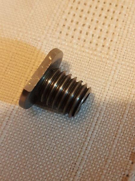

I got a set of ultegra brakes for my B14, when trying to install the rear brake I discovered the threads on the frame are much bigger than the shimano bolts. The original TRP brake has a pair of studs which bolt into the frame and then the brake arms slide over them.
I have access to a machine shop, so I was thinking about making my own adapter to use the ultegra brake, something like the picture below, I will make sure the flange matches the diameter of the brake seating pad and plan on keeping it at about 1/16" thick.
Do you see any potential issues with this solution?
I had a chance to go by the machine shop and make my adapters, it worked! I was able to install the ultegra brake on my B14!

Does that allow using any Ultegra rear brake or which model is that in pictures?
What are the threads inside and outside?
The brake in the pictures is an utlegra 6810. The mod should work for pretty much any direct mount brake which follows the same standard as Shimano.
Yeah, I realised it has to be direct mount after I asked. But what are the thread specifics for the adapter piece you made?
I will see if I can find the dimensions, think I left them inside one the empty brake boxes. Getting it is really easy, just need to measure the thread pitch and diameter of the TRP stud and the Shimano bolt.
When I did mine I took the parts to the machine shop, and they took care of the measuring.

My question is about the pins. So they screw out without issue? Anti clockwise? I noticed there was a pinch part at the base of the pin but they also look so integrated into the frame. I tried mildly unscrewing one but it didn’t budge and I was scared I was going to ruin my frame 😨

They are regular right hand thread screws, I was afraid of putting some force behind the pins too when I took them out. What I did is take a breaker bar so I could apply steady force instead of jerking them and once the locking compound gave way they came right out.
It is a good thing the Omegas come with bigger screws, you won’t have to worry about making adapters like I did

I found this post when looking at options for what will fit my B14 since I have had a headache adjusting the stock TRP brakes to handle the differences between my training wheels and my HED jet + wheels. I’ve got my new 6810r brake now and I pulled one of the studs in the frame. I measured the parts and the shimano brake uses a M6x1.0 thread, and the studs in the frame are M8x1.25. The depth of the threaded insert in the frame is ~15mm, and the thread of the bolt that came with my shimano brake is about 7mm long. I’ve asked a buddy that works at a machine stop to make me the adapters. Hopefully I can get this mounted up soon.

The upgrade on the rear brakes was definitely worth it. They are super easy to adjust and maintain now, I can switch between a wider set of rims (HED Jets) and the stock wheels with only a few minutes. A buddy of mine saw my results and has done it to his bike as well.
