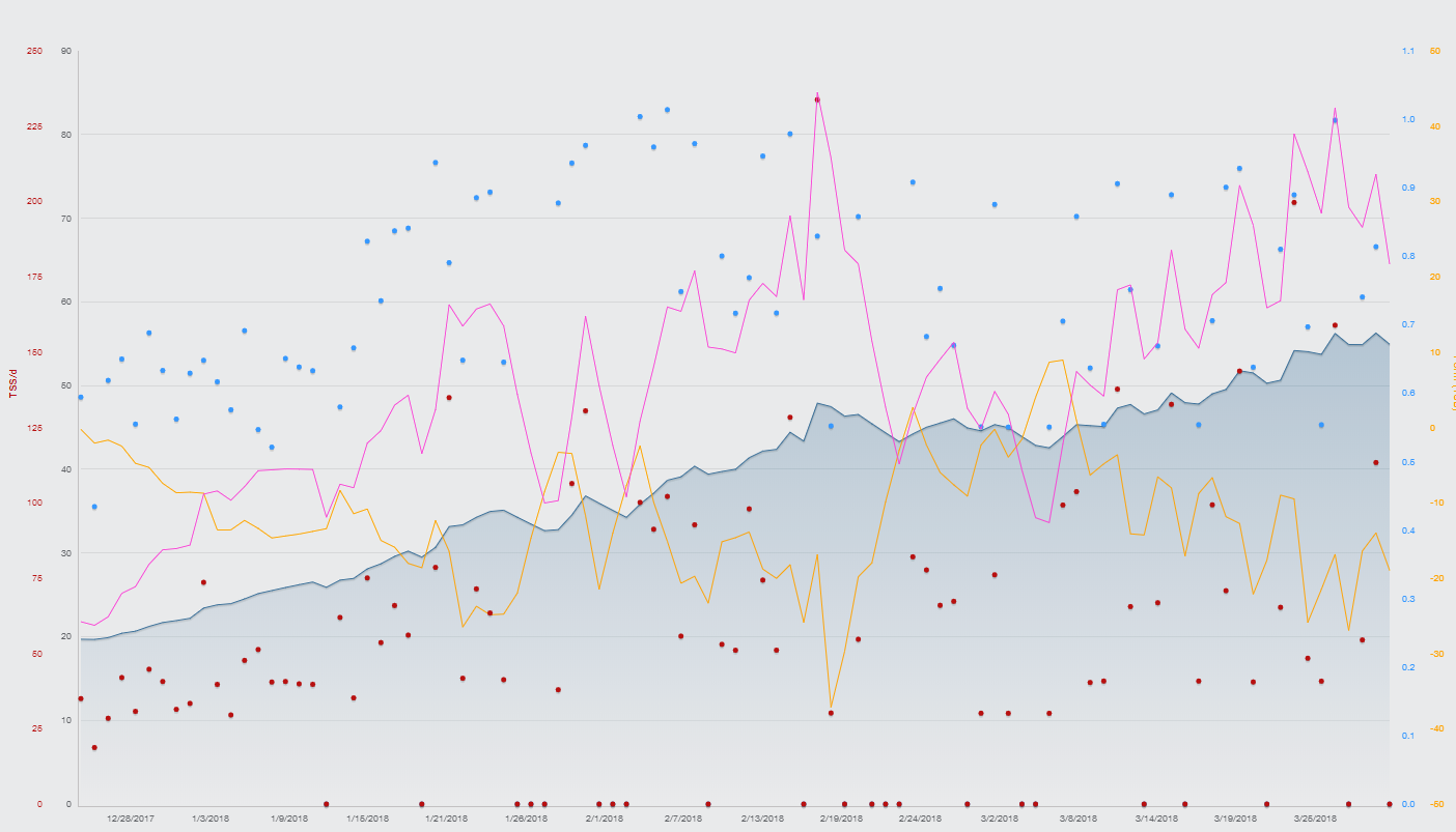

I’ve been using Strava and the Chrome extension stravistix to chart my progress and from the attached graph, all the Valleys are my indoor rides and only outdoor rides seems to elevate the lines in the graph.
Not-withstanding of course I set my Strava FTP as my outdoor FTP and it could be that this is making it look like I’m taking it easy indoors.
Thoughts? Clue?
Appreciated.
Note: Indoor TSS ~40-60 (1 hr ride)
Outdoor TSS ~80-200 (3 hr ride)

You seem to be reading too much into that graph. Despite how it is labeled, CTL does not directly equate to fitness, ATL does not directly equate to fatigue, and TSB does not directly equate to “form”.
The question you should be asking is whether your power over durations relavent to your event is increasing/decreasing/staying the same. From what you have written, it seems as if the latter is the case. If so, you might conclude that your indoor training is at least more time-efficient in helping you achieve your goals (I am assuming that you are not spending as much time training indoors as you used to do outdoors).
You are most definitely right that I am using that graph a_lot to base on where I should be and where I should be going. (that is after all, what the articles from Friel etc are saying) . But of course, you are right, it should be used as a guide as well.
Indoors is limited to mornings 1hr or so 3x per week. So 3hrs Weekdays and ~3-5hrs Weekends. Like everyone, I want to be a time-efficient and indoors is where it is time-efficient. If I can get everything done indoors and only do some 3hrs sessions outdoors 1x-2x per month that would be great. I don’t really want to drive an hour outdoors to ride for an hour.
Gist of it is, seeing the graph and the indoor workouts seems like they’re not contributing to my fitness seems a tad depressive. (of course, there’s the indoor vs outdoor FTP differences which could be the cause, then there’s also the - reading too much into the graph etc)
I guess I’m confused now. :frowning:
